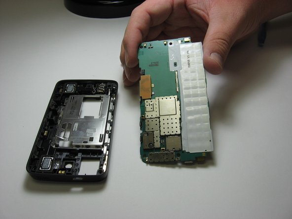

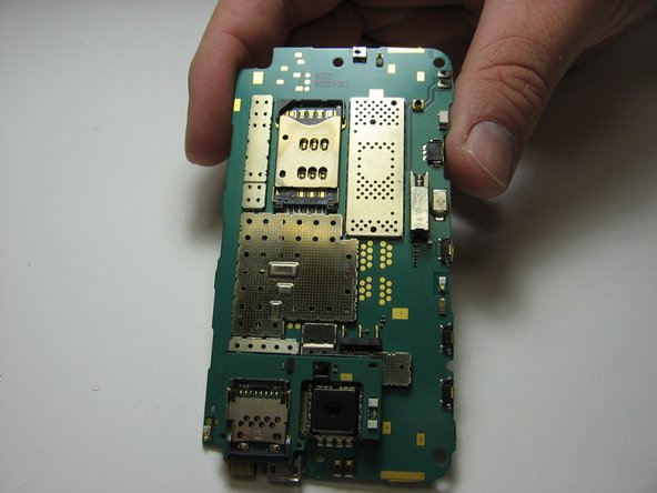

  7. Nokia N900 Teardown: crwdns2935265:07crwdnd2935265:01crwdnd2935265:03crwdne2935265:0 Nokia N900 Teardown: crwdns2935265:07crwdnd2935265:02crwdnd2935265:03crwdne2935265:0 Nokia N900 Teardown: crwdns2935265:07crwdnd2935265:03crwdnd2935265:03crwdne2935265:0
    • Slide the blue iFixit Opening Tool under the green motherboard and the base. Gently separate the green motherboard from the base of the phone.
