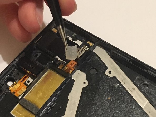

  19. Nokia Lumia 930 Vibration Module Replacement, Vibration Module: crwdns2935265:019crwdnd2935265:01crwdnd2935265:02crwdne2935265:0 Nokia Lumia 930 Vibration Module Replacement, Vibration Module: crwdns2935265:019crwdnd2935265:02crwdnd2935265:02crwdne2935265:0
    • Use a pair of tweezers to remove the vibration boot that covers the module.

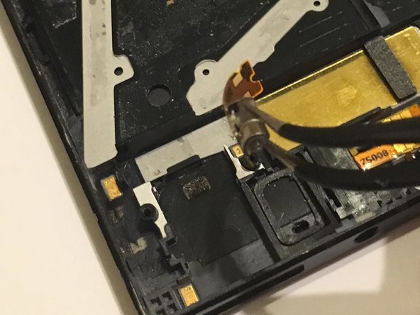

  20. Nokia Lumia 930 Vibration Module Replacement: crwdns2935265:020crwdnd2935265:01crwdnd2935265:01crwdne2935265:0
    • Use the flat end of the spudger to lift the module off of the adhesive.
    • Be delicate so that you don't break off the rotating piece of the module.
  21. Nokia Lumia 930 Vibration Module Replacement: crwdns2935265:021crwdnd2935265:01crwdnd2935265:02crwdne2935265:0 Nokia Lumia 930 Vibration Module Replacement: crwdns2935265:021crwdnd2935265:02crwdnd2935265:02crwdne2935265:0
    • Use tweezers to continually lift the module and flex up off of the adhesive.
    • Pull up until the vibration module is completely removed.
