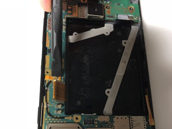

    • Use the flat end of a spudger to disconnect the six ribbon cables from the motherboard.
  13. Nokia Lumia 930 Screen Replacement: crwdns2935265:013crwdnd2935265:01crwdnd2935265:03crwdne2935265:0 Nokia Lumia 930 Screen Replacement: crwdns2935265:013crwdnd2935265:02crwdnd2935265:03crwdne2935265:0 Nokia Lumia 930 Screen Replacement: crwdns2935265:013crwdnd2935265:03crwdnd2935265:03crwdne2935265:0

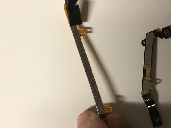

    • Use the flat end of a spudger to pry up the orange flex cable underneath the battery.
    • Remove the orange flex cable from the phone.
  14. Nokia Lumia 930 Screen Replacement: crwdns2935265:014crwdnd2935265:01crwdnd2935265:01crwdne2935265:0
    • Repeat the previous step for the black jumper flex cable under the battery.

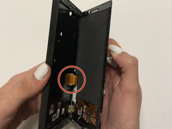

  19. Nokia Lumia 930 Screen Replacement, Display: crwdns2935265:019crwdnd2935265:01crwdnd2935265:03crwdne2935265:0 Nokia Lumia 930 Screen Replacement, Display: crwdns2935265:019crwdnd2935265:02crwdnd2935265:03crwdne2935265:0 Nokia Lumia 930 Screen Replacement, Display: crwdns2935265:019crwdnd2935265:03crwdnd2935265:03crwdne2935265:0
    • Place a suction cup in the center of the screen, then pry the display away from the frame.
    • When removing the display, pull slowly so that the flex cable does not become damaged.
    • Be sure to fold the display flex cable and ensure it is inserted safely when you are reassembling the display.
    • Remove any adhesive on the display and add new adhesive tape when reassembling the display.
