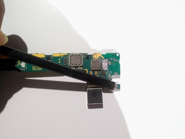

    • Locate all microphones. The first two microphones you will find are on the engine board. The two microphones will be back to back with each other. The third microphone will be on the engine cover. The last microphone will be on the last layer of the phone before the screen.
  20. Nokia Lumia 930 Microphone Removal: crwdns2935265:020crwdnd2935265:01crwdnd2935265:02crwdne2935265:0 Nokia Lumia 930 Microphone Removal: crwdns2935265:020crwdnd2935265:02crwdnd2935265:02crwdne2935265:0
    • You are gonna wanna use akistan to pop off the microphone.
    • Remove all remainings with the Spudger #2.
    • Repeat both steps on second microphone which is located on the other side of the first microphone.
    • Be gentle with the metal akistan it is stronger than the Spudger.
