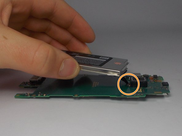

    • Now that the battery is separated from the motherboard, it is time to remove it. First you will need to lift the connector for the battery's ribbon cable.
    • Once the connector has been freed, you can start to pull the battery away from the motherboard.
    • Be careful of the ribbon cable connecting the battery to the motherboard. It is a bit tricky to pull through the hole, but patience is necessary.
    • Once you feed the ribbon cable out through the hole in the motherboard, the battery can be removed from the motherboard.
