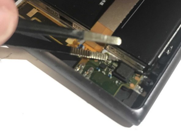

  17. Nokia Lumia 925 Battery Replacement: crwdns2935265:017crwdnd2935265:01crwdnd2935265:02crwdne2935265:0 Nokia Lumia 925 Battery Replacement: crwdns2935265:017crwdnd2935265:02crwdnd2935265:02crwdne2935265:0
    • Pry off the metal vibrating unit using tweezers.
    • This requires a lot of force.
  18. Nokia Lumia 925 Battery Replacement: crwdns2935265:018crwdnd2935265:01crwdnd2935265:02crwdne2935265:0 Nokia Lumia 925 Battery Replacement: crwdns2935265:018crwdnd2935265:02crwdnd2935265:02crwdne2935265:0
    • Insert the tweezers under the corner of the battery, and lift out.
    • You have successfully removed the battery.
