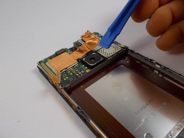

  9. Nokia Lumia 920 Volume, camera, and power ribbon. Replacement: crwdns2935265:09crwdnd2935265:01crwdnd2935265:01crwdne2935265:0
    • Use a plastic opening tool or spudger, and gently lift up on the connective piece.

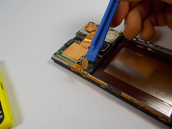

  11. Nokia Lumia 920 Volume, camera, and power ribbon. Replacement, Volume, camera, and power ribbon.: crwdns2935265:011crwdnd2935265:01crwdnd2935265:03crwdne2935265:0 Nokia Lumia 920 Volume, camera, and power ribbon. Replacement, Volume, camera, and power ribbon.: crwdns2935265:011crwdnd2935265:02crwdnd2935265:03crwdne2935265:0 Nokia Lumia 920 Volume, camera, and power ribbon. Replacement, Volume, camera, and power ribbon.: crwdns2935265:011crwdnd2935265:03crwdnd2935265:03crwdne2935265:0
    • Prerequisite guides: Back panel removal, Battery Removal
    • Use the plastic opening tool to gently lift up on the connective piece attached to the volume, camera, and power button strip.

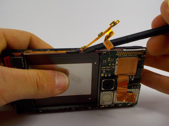

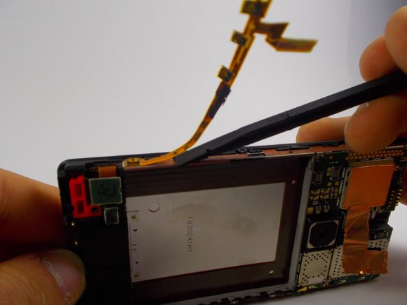

  12. Nokia Lumia 920 Volume, camera, and power ribbon. Replacement: crwdns2935265:012crwdnd2935265:01crwdnd2935265:03crwdne2935265:0 Nokia Lumia 920 Volume, camera, and power ribbon. Replacement: crwdns2935265:012crwdnd2935265:02crwdnd2935265:03crwdne2935265:0 Nokia Lumia 920 Volume, camera, and power ribbon. Replacement: crwdns2935265:012crwdnd2935265:03crwdnd2935265:03crwdne2935265:0
    • Flip the front panel on its side with the strip you are working on facing upward.
    • Use a spudger tool and starting at the top, gently pry the button sensors up.
    • Slide the tool underneath the strip and pry up the next button sensor.
    • Do this down the line until the strip becomes completely detached.
  13. Nokia Lumia 920 Volume, camera, and power ribbon. Replacement: crwdns2935265:013crwdnd2935265:01crwdnd2935265:01crwdne2935265:0
    • The power strip should look like this fully detached.
