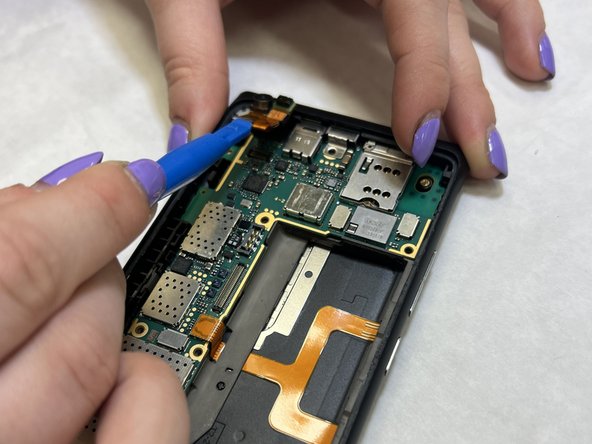

    • Disconnect the No-fuss cables from the motherboard by gently prying them up using the flat end of the black stick spudger. Make sure not to bend or crease the cable.
    • Remove the screen.

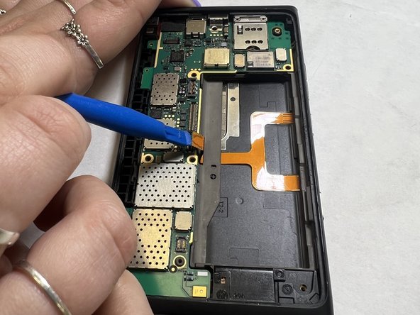

    • Use the plastic opening tool to lift the orange ribbon cable from the motherboard.

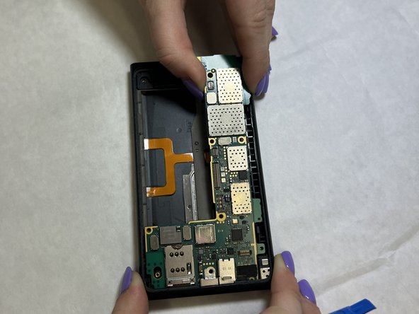

    • Use the plastic opening tool to lift the motherboard out of the casing.
    • It is recommended that you wedge the opening tool in the crevice between the motherboard and casing in the top righthand corner of the device.

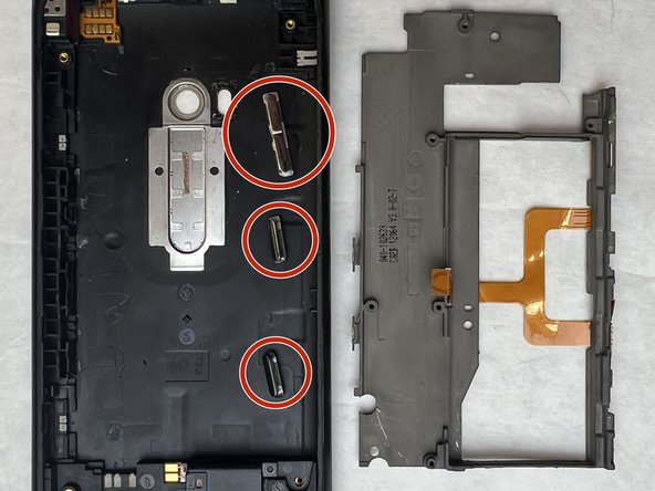

    • Use the flat end of a spudger to lift the metal backplate from the casing.
    • Be sure not to lose the buttons.
  13. Nokia Lumia 900 Speaker Replacement: crwdns2935265:013crwdnd2935265:01crwdnd2935265:02crwdne2935265:0 Nokia Lumia 900 Speaker Replacement: crwdns2935265:013crwdnd2935265:02crwdnd2935265:02crwdne2935265:0

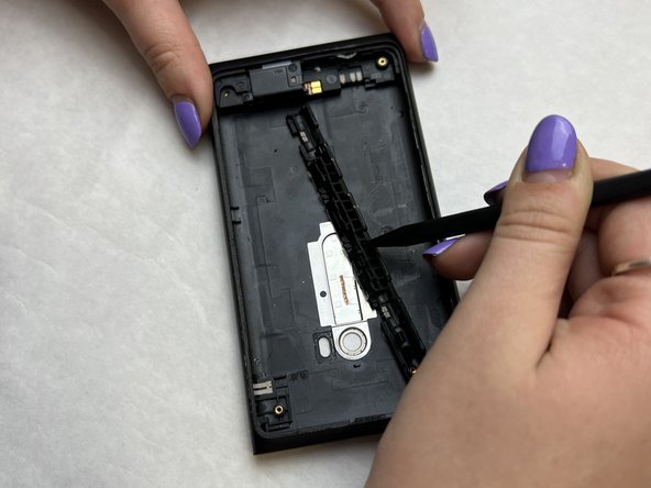

    • Wedge the pointed end of the spudger into the gaps in the antenna housing and pull the antenna housing away from the casing walls.

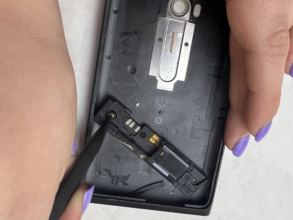

    • Insert the pointed end of the spudger into the hole and slide the speaker housing out from the casing.
