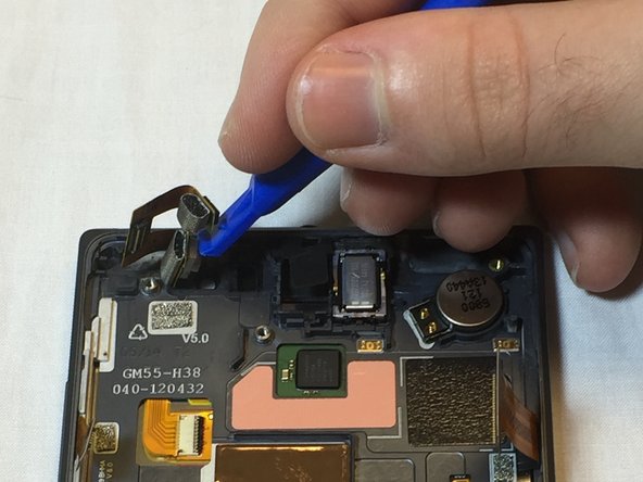

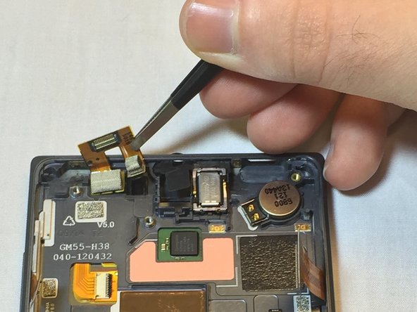

  10. Nokia Lumia 830 Vibrator Replacement, Front Camera: crwdns2935265:010crwdnd2935265:01crwdnd2935265:03crwdne2935265:0 Nokia Lumia 830 Vibrator Replacement, Front Camera: crwdns2935265:010crwdnd2935265:02crwdnd2935265:03crwdne2935265:0 Nokia Lumia 830 Vibrator Replacement, Front Camera: crwdns2935265:010crwdnd2935265:03crwdnd2935265:03crwdne2935265:0
    • The marked area in the image is the front facing camera and its flex assembly anchor.
    • Use a pair of tweezers to lift up the right side of the flex assembly anchor.
    • Then, use the plastic opening tool to lift up the the front facing camera, then remove completely with tweezers.

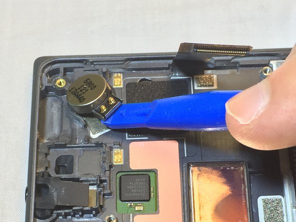

  11. Nokia Lumia 830 Vibrator Replacement, Earpiece Speaker: crwdns2935265:011crwdnd2935265:01crwdnd2935265:01crwdne2935265:0
    • The speaker is located at the top of the device to the right of the headphone jack.

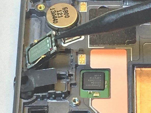

  12. Nokia Lumia 830 Vibrator Replacement: crwdns2935265:012crwdnd2935265:01crwdnd2935265:02crwdne2935265:0 Nokia Lumia 830 Vibrator Replacement: crwdns2935265:012crwdnd2935265:02crwdnd2935265:02crwdne2935265:0
    • Use the pointy end of the spudger to firmly lift the earpiece speaker out of the socket.

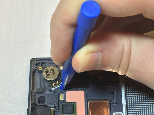

  13. Nokia Lumia 830 Vibrator Replacement, Vibrator: crwdns2935265:013crwdnd2935265:01crwdnd2935265:03crwdne2935265:0 Nokia Lumia 830 Vibrator Replacement, Vibrator: crwdns2935265:013crwdnd2935265:02crwdnd2935265:03crwdne2935265:0 Nokia Lumia 830 Vibrator Replacement, Vibrator: crwdns2935265:013crwdnd2935265:03crwdnd2935265:03crwdne2935265:0
    • The vibrator is highlighted in the image provided.
    • Use the plastic opening tool to lift the vibrator from the base of the phone.
    • You may need to use a bit of force to lift it up completely
    • Remove completely using tweezers.
