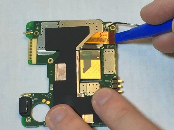

  10. Nokia Lumia 830 Main Camera Replacement, Main Camera: crwdns2935265:010crwdnd2935265:01crwdnd2935265:02crwdne2935265:0 Nokia Lumia 830 Main Camera Replacement, Main Camera: crwdns2935265:010crwdnd2935265:02crwdnd2935265:02crwdne2935265:0
    • After you've removed the motherboard, locate the camera connector at the bottom right hand corner of the motherboard, as shown in the image.
    • Gently use the plastic opening tool to lift the connectors, disconnecting the camera from the motherboard.
    • Lastly, use tweezers to remove completely.
