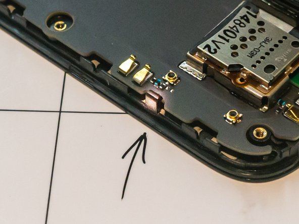

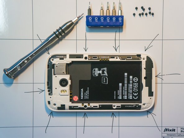

  3. Nokia Lumia 822 Basic Disassembly: crwdns2935265:03crwdnd2935265:01crwdnd2935265:02crwdne2935265:0 Nokia Lumia 822 Basic Disassembly: crwdns2935265:03crwdnd2935265:02crwdnd2935265:02crwdne2935265:0
    • Locate and remove the ten T4 Torx screws around the perimeter of the frame. (indicated by arrows)
    • These screws have threadlocker on them, the amount varies. Occasionally they are so tight that the head twists off. When reassembling, do NOT overtighten them, as this can crack the LCD.

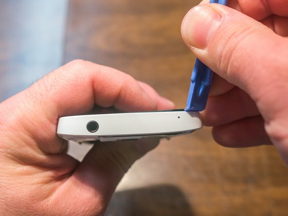

  4. Nokia Lumia 822 Basic Disassembly: crwdns2935265:04crwdnd2935265:01crwdnd2935265:03crwdne2935265:0 Nokia Lumia 822 Basic Disassembly: crwdns2935265:04crwdnd2935265:02crwdnd2935265:03crwdne2935265:0 Nokia Lumia 822 Basic Disassembly: crwdns2935265:04crwdnd2935265:03crwdnd2935265:03crwdne2935265:0
    • Hold the top of the phone's frame between your fingers, and gently apply pressure on the back of the LCD assembly. Do not use too much force. Move your thumbs around to apply pressure at various points.
    • When viewed from the front, the top left corner of the screen will usually be the first to pop loose.
    • Run a plastic opening tool or a thumbnail along the top of the screen to free it from the frame assembly.

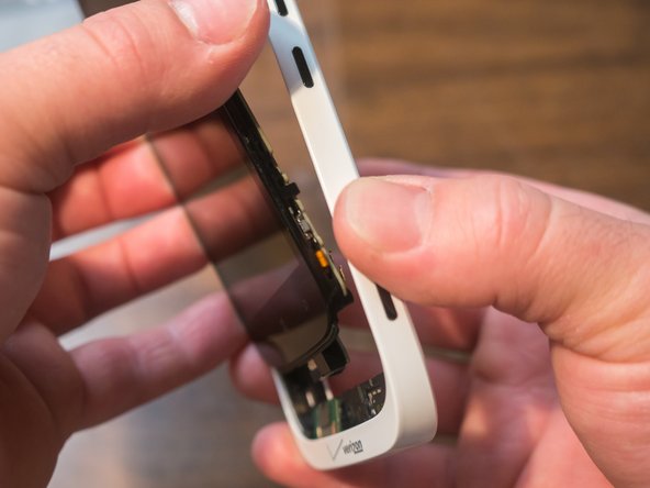

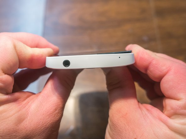

  5. Nokia Lumia 822 Basic Disassembly: crwdns2935265:05crwdnd2935265:01crwdnd2935265:03crwdne2935265:0 Nokia Lumia 822 Basic Disassembly: crwdns2935265:05crwdnd2935265:02crwdnd2935265:03crwdne2935265:0 Nokia Lumia 822 Basic Disassembly: crwdns2935265:05crwdnd2935265:03crwdnd2935265:03crwdne2935265:0
    • Once the top of the screen assembly is free, pull it out so it clears the edge of the frame.
    • Pull the screen assembly straight up to free the bottom portion from the frame. The frame can now be set aside, as we will concentrate on the screen/logic board assembly.

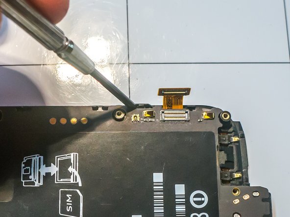

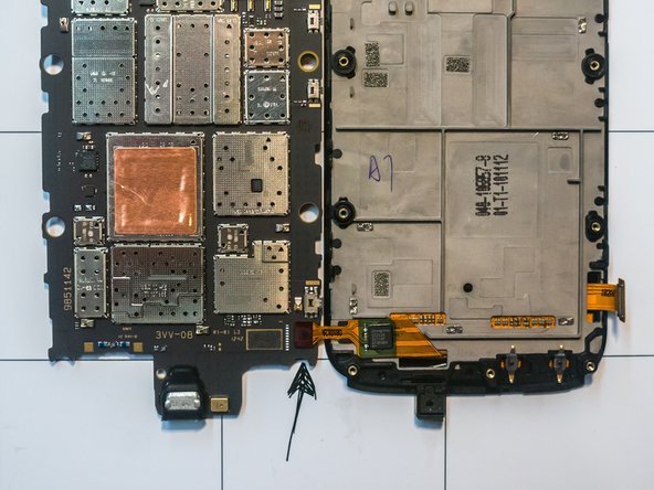

  6. Nokia Lumia 822 Basic Disassembly: crwdns2935265:06crwdnd2935265:01crwdnd2935265:02crwdne2935265:0 Nokia Lumia 822 Basic Disassembly: crwdns2935265:06crwdnd2935265:02crwdnd2935265:02crwdne2935265:0
    • Locate the ribbon cable on the back of the logic board and carefully loosen the connector with a plastic opening tool. Be sure you are prying on the cable's connector, and not on the plug on the logic board.

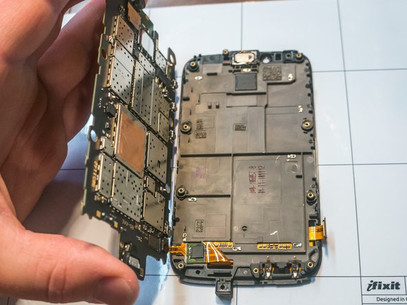

  8. Nokia Lumia 822 Basic Disassembly: crwdns2935265:08crwdnd2935265:01crwdnd2935265:03crwdne2935265:0 Nokia Lumia 822 Basic Disassembly: crwdns2935265:08crwdnd2935265:02crwdnd2935265:03crwdne2935265:0 Nokia Lumia 822 Basic Disassembly: crwdns2935265:08crwdnd2935265:03crwdnd2935265:03crwdne2935265:0
    • Raise the logic board by the edge freed in the previous step, and slide it from underneath the remaining clips on the other side.
    • There is a second ribbon cable directly across from the first, on the underside of the logic board, visible in the last two photos.
    • Carefully flip the logic board and set it on the workspace next to the screen assembly. Take care to avoid damaging the ribbon cable.

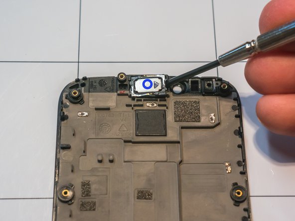

  9. Nokia Lumia 822 Basic Disassembly: crwdns2935265:09crwdnd2935265:01crwdnd2935265:02crwdne2935265:0 Nokia Lumia 822 Basic Disassembly: crwdns2935265:09crwdnd2935265:02crwdnd2935265:02crwdne2935265:0
    • Use a plastic opening tool to free the ribbon cable connector, again making sure to pry only on the cable's connector.
    • The only replaceable part on the screen assembly is the earpiece speaker, although removing it will ruin the double-sided foam adhesive strip that holds it in place.

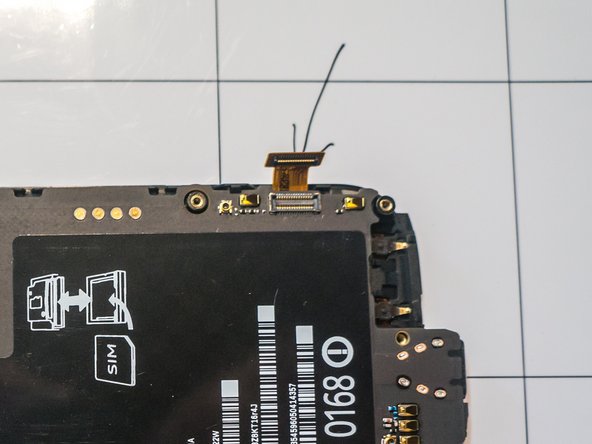

  10. Nokia Lumia 822 Basic Disassembly: crwdns2935265:010crwdnd2935265:01crwdnd2935265:01crwdne2935265:0
    • On the logic board, the front facing camera, along with the proximity and light sensors can be removed simply by loosening the connector with a plastic opening tool.

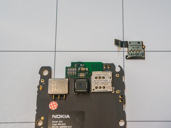

  11. Nokia Lumia 822 Basic Disassembly: crwdns2935265:011crwdnd2935265:01crwdnd2935265:03crwdne2935265:0 Nokia Lumia 822 Basic Disassembly: crwdns2935265:011crwdnd2935265:02crwdnd2935265:03crwdne2935265:0 Nokia Lumia 822 Basic Disassembly: crwdns2935265:011crwdnd2935265:03crwdnd2935265:03crwdne2935265:0
    • To remove the Micro-SD slot, begin by freeing the connector from the logic board using a plastic opening tool.
    • The Micro-SD slot is adhered to the SIM slot using a medium adhesive. Use a hobby knife to free it, carefully sliding it between the two slots.
    • Be sure to move slowly and with as little force as necessary to reduce the chance of injury or damaging a component.

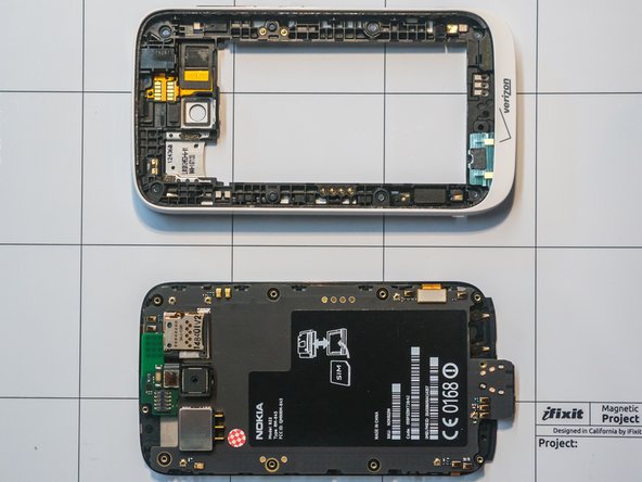

  12. Nokia Lumia 822 Basic Disassembly: crwdns2935265:012crwdnd2935265:01crwdnd2935265:01crwdne2935265:0
    • Basic disassembly is complete.
    • When reassembling, be very careful when connecting ribbon cables. The connectors are delicate. Make sure the connectors are lined up before applying any pressure, and do not use excessive force.
