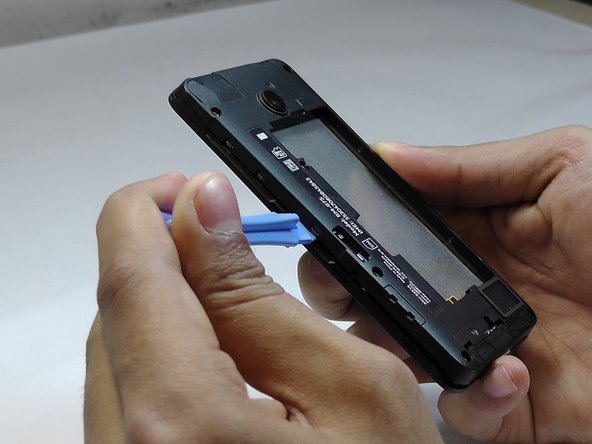

    • Open the back case of the phone using the plastic opening tool.
    • Remove the battery.
