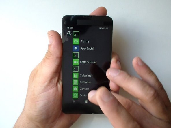

  4. Nokia Lumia 635 Display Assembly Replacement, TESTING THE NEW SPARE PART: crwdns2935265:04crwdnd2935265:01crwdnd2935265:03crwdne2935265:0 Nokia Lumia 635 Display Assembly Replacement, TESTING THE NEW SPARE PART: crwdns2935265:04crwdnd2935265:02crwdnd2935265:03crwdne2935265:0 Nokia Lumia 635 Display Assembly Replacement, TESTING THE NEW SPARE PART: crwdns2935265:04crwdnd2935265:03crwdnd2935265:03crwdne2935265:0
    • Insert wisdom here.

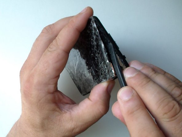

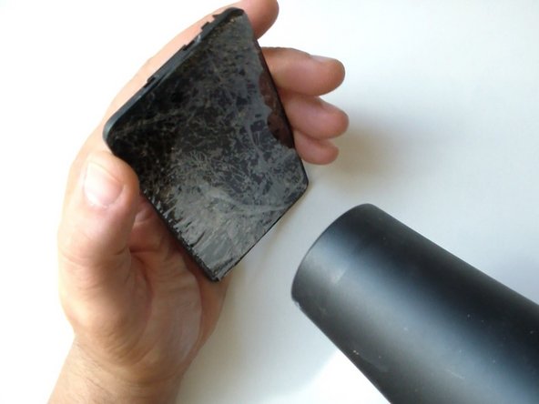

  5. Nokia Lumia 635 Display Assembly Replacement, DISPLAY ASSEMBLY STEP 1: crwdns2935265:05crwdnd2935265:01crwdnd2935265:02crwdne2935265:0 Nokia Lumia 635 Display Assembly Replacement, DISPLAY ASSEMBLY STEP 1: crwdns2935265:05crwdnd2935265:02crwdnd2935265:02crwdne2935265:0
    • Put some scotch tape to prevent the glass from scattering.
    • Use a hot gun or hair dryer and warm the glass to soften the adhesive.

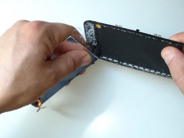

  6. Nokia Lumia 635 Display Assembly Replacement, DISPLAY ASSEMBLY STEP 2: crwdns2935265:06crwdnd2935265:01crwdnd2935265:03crwdne2935265:0 Nokia Lumia 635 Display Assembly Replacement, DISPLAY ASSEMBLY STEP 2: crwdns2935265:06crwdnd2935265:02crwdnd2935265:03crwdne2935265:0 Nokia Lumia 635 Display Assembly Replacement, DISPLAY ASSEMBLY STEP 2: crwdns2935265:06crwdnd2935265:03crwdnd2935265:03crwdne2935265:0
    • Start the separating from the upper right corner, where you have an hole in the middle frame.
    • Use plastic tool to prevent the middle frame from scratches.
    • Work slowly, you can cut your fingers.

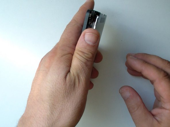

  7. Nokia Lumia 635 Display Assembly Replacement, MIDDLE FRAME: crwdns2935265:07crwdnd2935265:01crwdnd2935265:03crwdne2935265:0 Nokia Lumia 635 Display Assembly Replacement, MIDDLE FRAME: crwdns2935265:07crwdnd2935265:02crwdnd2935265:03crwdne2935265:0 Nokia Lumia 635 Display Assembly Replacement, MIDDLE FRAME: crwdns2935265:07crwdnd2935265:03crwdnd2935265:03crwdne2935265:0
    • Clean the middle farme.
    • Put adhesive tape 3MM.
    • Be careful, don't cover the technological openings on the middle frame (for the light sensor, earpiece, etc.).
    • It's easier if you order the spare part together with an adhesive tape.
    • Install the display assembly.

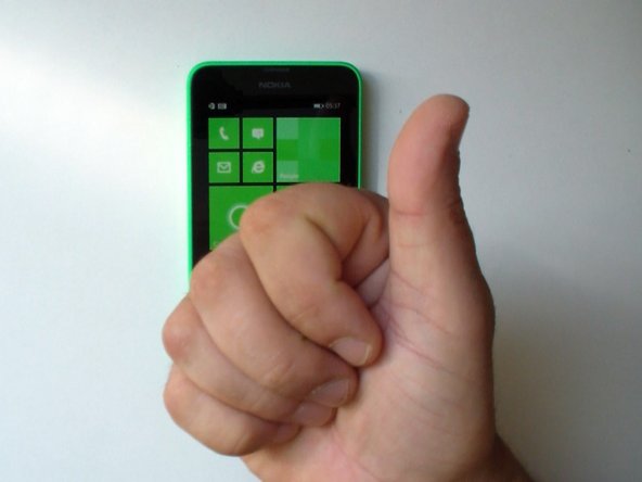

  8. Nokia Lumia 635 Display Assembly Replacement: crwdns2935265:08crwdnd2935265:01crwdnd2935265:02crwdne2935265:0 Nokia Lumia 635 Display Assembly Replacement: crwdns2935265:08crwdnd2935265:02crwdnd2935265:02crwdne2935265:0
    • That's all.
    • Did you do it successfully?
