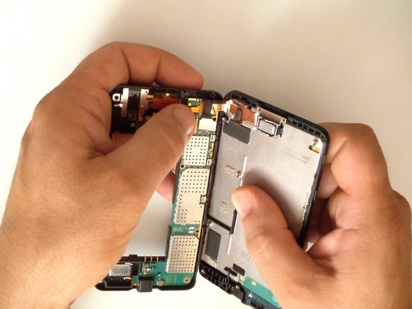

  3. Nokia Lumia 635 630 Display Assembly Replacement with Frame: crwdns2935265:03crwdnd2935265:01crwdnd2935265:03crwdne2935265:0 Nokia Lumia 635 630 Display Assembly Replacement with Frame: crwdns2935265:03crwdnd2935265:02crwdnd2935265:03crwdne2935265:0 Nokia Lumia 635 630 Display Assembly Replacement with Frame: crwdns2935265:03crwdnd2935265:03crwdnd2935265:03crwdne2935265:0

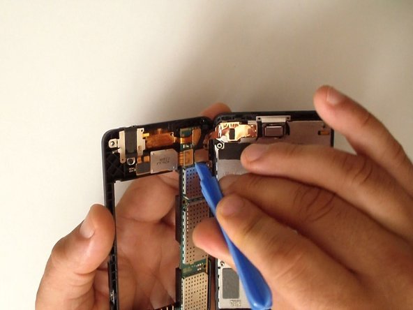

    • Lift the rear bezel and unhook the display assembly flex cable.
    • Don't use a metal tool for disconnecting the flex cable. There are many small elements near the connectors. You could break them. If you don't have a suitable tool just use your nails.

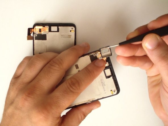

    • Now we have to transfer the earpiece.
  4. Nokia Lumia 635 630 Display Assembly Replacement with Frame, LOUDSPEAKER: crwdns2935265:04crwdnd2935265:01crwdnd2935265:03crwdne2935265:0 Nokia Lumia 635 630 Display Assembly Replacement with Frame, LOUDSPEAKER: crwdns2935265:04crwdnd2935265:02crwdnd2935265:03crwdne2935265:0 Nokia Lumia 635 630 Display Assembly Replacement with Frame, LOUDSPEAKER: crwdns2935265:04crwdnd2935265:03crwdnd2935265:03crwdne2935265:0
    • Put the earpiece on the new display assembly and start with reassembling.
