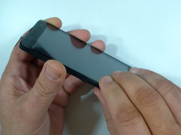

    • Turn off the phone and remove the back cover.
    • Remove any installed SIM or memory card.
    • Use a screwdriver Torx T5 and remove the 8x black screws.

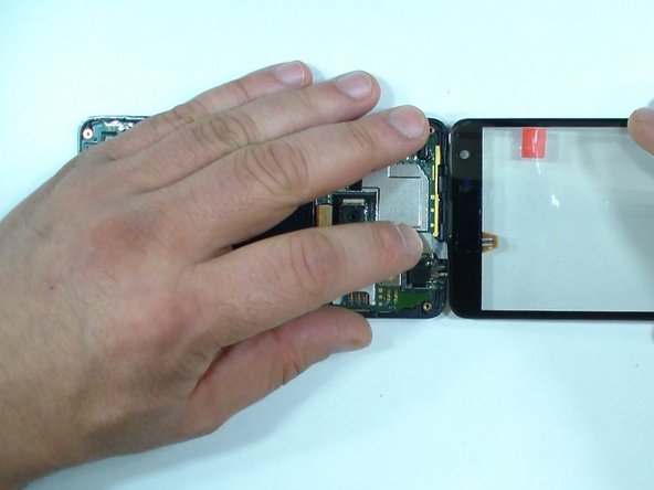

  3. Nokia Lumia 625 Touch Screen Digitizer Glass Replacement, Touch Screen Digitizer Glass: crwdns2935265:03crwdnd2935265:01crwdnd2935265:03crwdne2935265:0 Nokia Lumia 625 Touch Screen Digitizer Glass Replacement, Touch Screen Digitizer Glass: crwdns2935265:03crwdnd2935265:02crwdnd2935265:03crwdne2935265:0 Nokia Lumia 625 Touch Screen Digitizer Glass Replacement, Touch Screen Digitizer Glass: crwdns2935265:03crwdnd2935265:03crwdnd2935265:03crwdne2935265:0
    • Disconnect the battery and the touch screen flex cables.
    • Now is the moment for test the new spare part.
    • Finally, disconnect the battery again and remove the new touch screen.

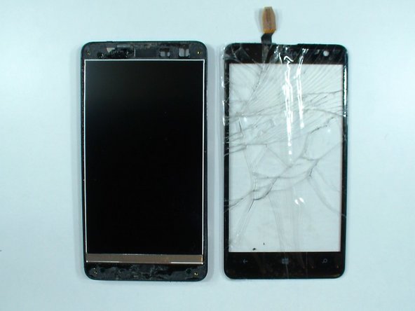

  4. Nokia Lumia 625 Touch Screen Digitizer Glass Replacement: crwdns2935265:04crwdnd2935265:01crwdnd2935265:02crwdne2935265:0 Nokia Lumia 625 Touch Screen Digitizer Glass Replacement: crwdns2935265:04crwdnd2935265:02crwdnd2935265:02crwdne2935265:0
    • Put some scotch tape to prevent the glass from shattering and yourself from injury.
    • Use a hair dryer and warm the glass to make adhesive soften.

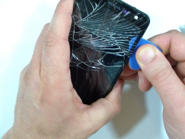

  5. Nokia Lumia 625 Touch Screen Digitizer Glass Replacement: crwdns2935265:05crwdnd2935265:01crwdnd2935265:03crwdne2935265:0 Nokia Lumia 625 Touch Screen Digitizer Glass Replacement: crwdns2935265:05crwdnd2935265:02crwdnd2935265:03crwdne2935265:0 Nokia Lumia 625 Touch Screen Digitizer Glass Replacement: crwdns2935265:05crwdnd2935265:03crwdnd2935265:03crwdne2935265:0
    • With a cutter separate the glass a little bit to make a room for the plastic pick or other plastic tool.
    • Be careful for the LCD. You can use a hair dryer again to rewarm the glass.

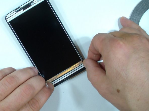

  6. Nokia Lumia 625 Touch Screen Digitizer Glass Replacement: crwdns2935265:06crwdnd2935265:01crwdnd2935265:03crwdne2935265:0 Nokia Lumia 625 Touch Screen Digitizer Glass Replacement: crwdns2935265:06crwdnd2935265:02crwdnd2935265:03crwdne2935265:0 Nokia Lumia 625 Touch Screen Digitizer Glass Replacement: crwdns2935265:06crwdnd2935265:03crwdnd2935265:03crwdne2935265:0
    • Clean the frame of the old adhesive tape and install new.

Another comment: I was attempting to do this guide and the LCD is glued to the digitizer! It's very important to disclose this at the beginning of the guide. You could end up with a broken LCD!
Do not try this if the original glass broke, because it's glued to the LCD and removing the broken glass could damage it.
carlitossuper1 - crwdns2934203:0crwdne2934203:0
That is not true carlitossuper1, the LCD and the digitizer are not fised together. Glue is only around the frame.
