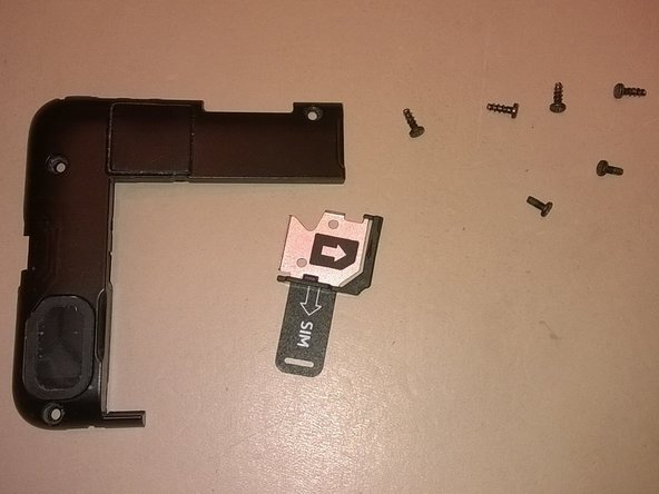

  3. Nokia Lumia 620 Volume and Power Button Replacement: crwdns2935265:03crwdnd2935265:01crwdnd2935265:01crwdne2935265:0
    • Remove cover, battery and SIM
    • Remove 6 torx screws
    • Note: Green is fine thread
    • Note: Red is coarse thread

Only the 2 middle screws are fine threaded. And you can see in the pictures here, that there are 4 coarse threaded ones and 2 fine threaded ones. The green one in the corner should be red
