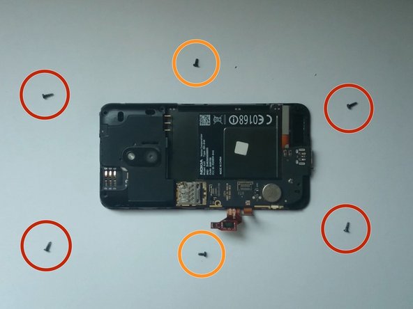

    • Switch off the phone, remove the battery and SIM (Memory) card.
    • The lower back cover is held by 3x T4 Torx screws.
    • The screws are of two types!

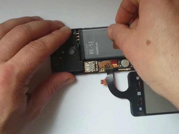

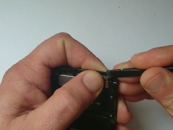

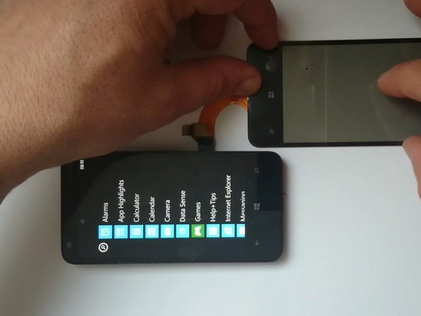

  3. Nokia Lumia 620 LCD Display, Touch screen Glass, Touch screen Test: crwdns2935265:03crwdnd2935265:01crwdnd2935265:03crwdne2935265:0 Nokia Lumia 620 LCD Display, Touch screen Glass, Touch screen Test: crwdns2935265:03crwdnd2935265:02crwdnd2935265:03crwdne2935265:0 Nokia Lumia 620 LCD Display, Touch screen Glass, Touch screen Test: crwdns2935265:03crwdnd2935265:03crwdnd2935265:03crwdne2935265:0
    • If you want to replace the Digitizer, let's test the spare part first.
    • Be careful, don't break the flex cable.

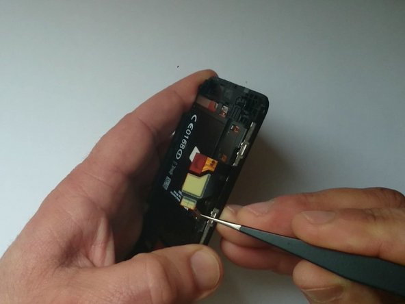

  4. Nokia Lumia 620 LCD Display, Touch screen Glass: crwdns2935265:04crwdnd2935265:01crwdnd2935265:03crwdne2935265:0 Nokia Lumia 620 LCD Display, Touch screen Glass: crwdns2935265:04crwdnd2935265:02crwdnd2935265:03crwdne2935265:0 Nokia Lumia 620 LCD Display, Touch screen Glass: crwdns2935265:04crwdnd2935265:03crwdnd2935265:03crwdne2935265:0
    • Another three screws hold the Upper Back Cover.
    • Disconnect the Touch screen and the Digitizer flex cables.

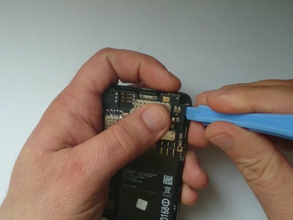

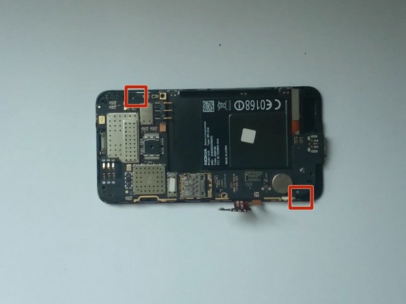

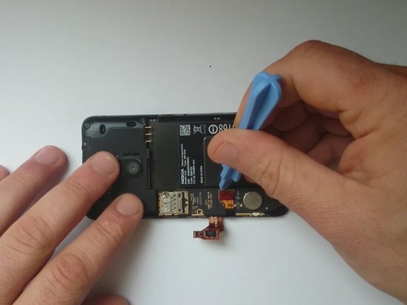

  5. Nokia Lumia 620 LCD Display, Touch screen Glass: crwdns2935265:05crwdnd2935265:01crwdnd2935265:02crwdne2935265:0 Nokia Lumia 620 LCD Display, Touch screen Glass: crwdns2935265:05crwdnd2935265:02crwdnd2935265:02crwdne2935265:0
    • If you have not yet disconnected the Digitizer and the Touch screen flex cables, do it now.
    • The Logic Board is held to the Middle frame by two plastic clips.

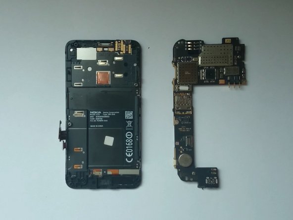

  6. Nokia Lumia 620 LCD Display, Touch screen Glass: crwdns2935265:06crwdnd2935265:01crwdnd2935265:03crwdne2935265:0 Nokia Lumia 620 LCD Display, Touch screen Glass: crwdns2935265:06crwdnd2935265:02crwdnd2935265:03crwdne2935265:0 Nokia Lumia 620 LCD Display, Touch screen Glass: crwdns2935265:06crwdnd2935265:03crwdnd2935265:03crwdne2935265:0
    • With a plastic tool gently release the mother board and remove it.

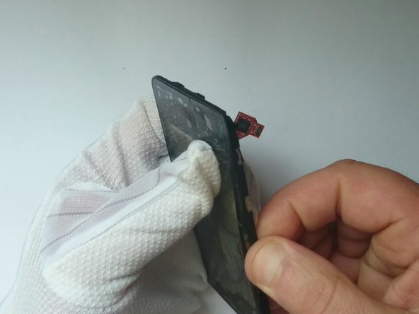

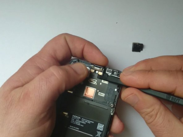

  7. Nokia Lumia 620 LCD Display, Touch screen Glass: crwdns2935265:07crwdnd2935265:01crwdnd2935265:03crwdne2935265:0 Nokia Lumia 620 LCD Display, Touch screen Glass: crwdns2935265:07crwdnd2935265:02crwdnd2935265:03crwdne2935265:0 Nokia Lumia 620 LCD Display, Touch screen Glass: crwdns2935265:07crwdnd2935265:03crwdnd2935265:03crwdne2935265:0
    • Front Camera and Proximity & Light sensor module
    • Earpiece
    • Remove them one by one.

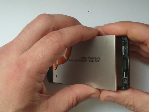

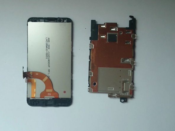

  8. Nokia Lumia 620 LCD Display, Touch screen Glass: crwdns2935265:08crwdnd2935265:01crwdnd2935265:03crwdne2935265:0 Nokia Lumia 620 LCD Display, Touch screen Glass: crwdns2935265:08crwdnd2935265:02crwdnd2935265:03crwdne2935265:0 Nokia Lumia 620 LCD Display, Touch screen Glass: crwdns2935265:08crwdnd2935265:03crwdnd2935265:03crwdne2935265:0
    • The Midle frame is held by 6x locking clips, three on each side. Release them and remove the Middle frame.
  9. Nokia Lumia 620 LCD Display, Touch screen Glass: crwdns2935265:09crwdnd2935265:01crwdnd2935265:03crwdne2935265:0 Nokia Lumia 620 LCD Display, Touch screen Glass: crwdns2935265:09crwdnd2935265:02crwdnd2935265:03crwdne2935265:0 Nokia Lumia 620 LCD Display, Touch screen Glass: crwdns2935265:09crwdnd2935265:03crwdnd2935265:03crwdne2935265:0
    • Now gently remove the LCD Display.

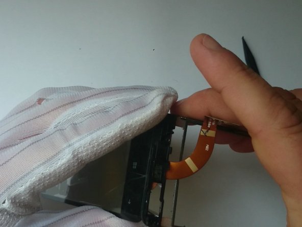

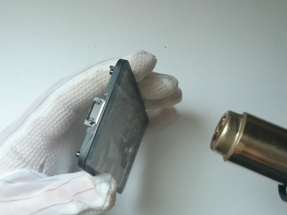

  10. Nokia Lumia 620 LCD Display, Touch screen Glass: crwdns2935265:010crwdnd2935265:01crwdnd2935265:03crwdne2935265:0 Nokia Lumia 620 LCD Display, Touch screen Glass: crwdns2935265:010crwdnd2935265:02crwdnd2935265:03crwdne2935265:0 Nokia Lumia 620 LCD Display, Touch screen Glass: crwdns2935265:010crwdnd2935265:03crwdnd2935265:03crwdne2935265:0
    • Put a scotch tape to prevent the glass from scattering.
    • With a hot air warm the glass to soften the adhesive.
    • You can use a hair dryer for this operation.
    • Start with separating at the middle, where the bonded area is smaller.

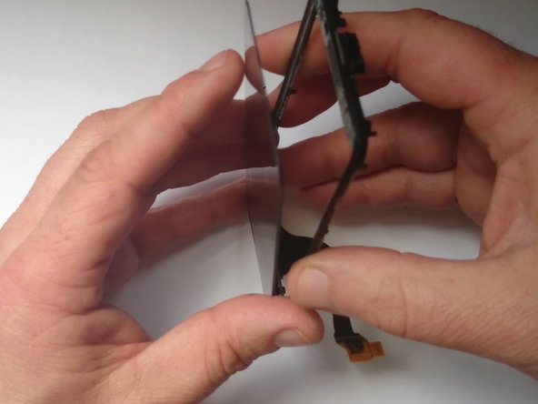

  11. Nokia Lumia 620 LCD Display, Touch screen Glass: crwdns2935265:011crwdnd2935265:01crwdnd2935265:03crwdne2935265:0 Nokia Lumia 620 LCD Display, Touch screen Glass: crwdns2935265:011crwdnd2935265:02crwdnd2935265:03crwdne2935265:0 Nokia Lumia 620 LCD Display, Touch screen Glass: crwdns2935265:011crwdnd2935265:03crwdnd2935265:03crwdne2935265:0
    • Continue with the separation by using a plastic tool.
  12. Nokia Lumia 620 LCD Display, Touch screen Glass: crwdns2935265:012crwdnd2935265:01crwdnd2935265:03crwdne2935265:0 Nokia Lumia 620 LCD Display, Touch screen Glass: crwdns2935265:012crwdnd2935265:02crwdnd2935265:03crwdne2935265:0 Nokia Lumia 620 LCD Display, Touch screen Glass: crwdns2935265:012crwdnd2935265:03crwdnd2935265:03crwdne2935265:0

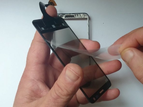

    • Clean the remnants of the old adhesive tape.
    • If the spare parts come without adhesive tape, you must put by himself.
    • Prepare the new digitizer glass and install it.
    • Reassemble the device.
