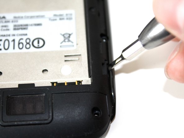

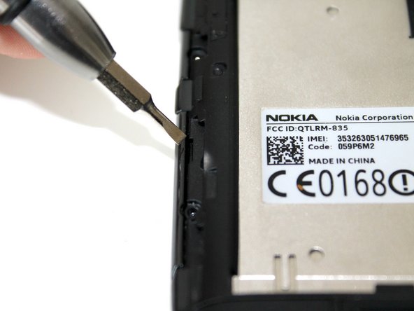

    • After removing all 8 screws, proceed to prying off the back cover
    • This is done very easily, by prying it from the 3 grooves depicted
    • This step might also be done using your nails, as the clips are not strong at all

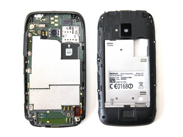

  6. Nokia Lumia 610 Touchscreen Glass / Digitizer Assembly Replacement: crwdns2935265:06crwdnd2935265:01crwdnd2935265:02crwdne2935265:0 Nokia Lumia 610 Touchscreen Glass / Digitizer Assembly Replacement: crwdns2935265:06crwdnd2935265:02crwdnd2935265:02crwdne2935265:0
    • Lift the back cover up, and pull it back - most likely, the 2 sided tape sealing the camera module will be the last thing to break loose
    • Make sure you stick it back to the rear case assembly after this step

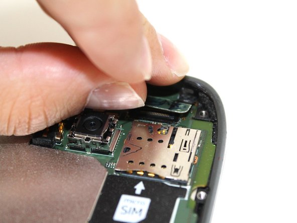

    • Disconnect the 2 ribbon cables connecting the LCD & Digitizer to the motherboard

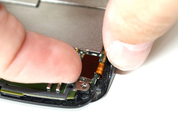

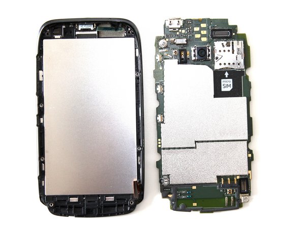

    • Now to separate the Motherboard from the front assembly !
    • Gently pry on the 2 hooks depicted in the picture to release the motherboard
    • Again - using your nails should be just fine !
  9. Nokia Lumia 610 Touchscreen Glass / Digitizer Assembly Replacement: crwdns2935265:09crwdnd2935265:01crwdnd2935265:02crwdne2935265:0 Nokia Lumia 610 Touchscreen Glass / Digitizer Assembly Replacement: crwdns2935265:09crwdnd2935265:02crwdnd2935265:02crwdne2935265:0
    • Lift the motherboard up from the back, and pull it backwards
    • Apply the same motion as with the back casing

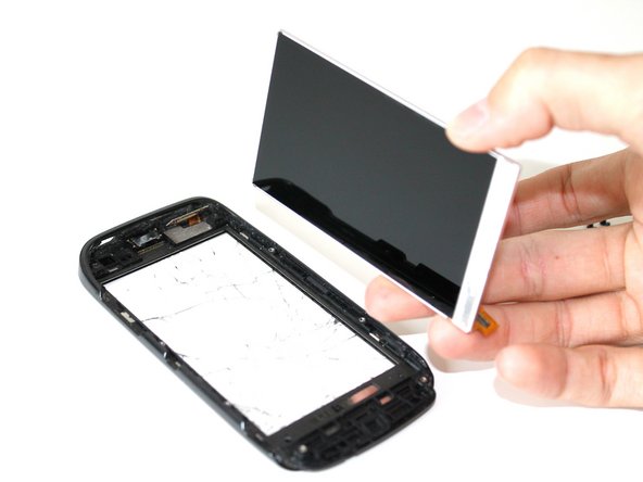

    • You should now have separated the motherboard from the LCD/Digitizer Assembly
  10. Nokia Lumia 610 Touchscreen Glass / Digitizer Assembly Replacement: crwdns2935265:010crwdnd2935265:01crwdnd2935265:02crwdne2935265:0 Nokia Lumia 610 Touchscreen Glass / Digitizer Assembly Replacement: crwdns2935265:010crwdnd2935265:02crwdnd2935265:02crwdne2935265:0
    • To detach the LCD, gently lift it from the sides - be careful, and don't pull too hard on the ribbon cable !
    • It's secured in with pretty weak double-sided tape, so this step shouldn't be a problem

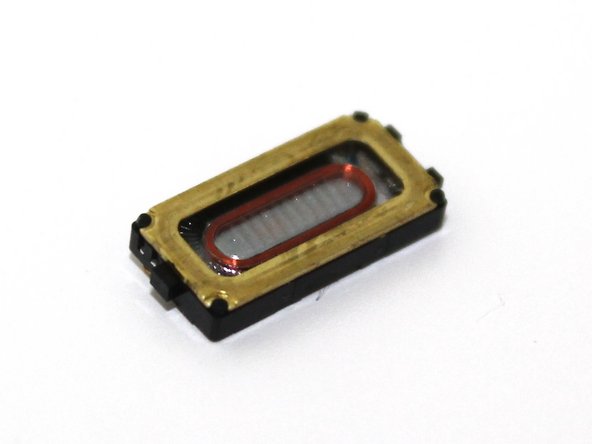

    • Remove the ear-piece speaker from the Digitizer Assembly
    • It's held in by - again - pretty weak double-sided tape
    • 2nd picture gives you a look of the front of the speaker unit - it's pretty hard to damage the membrane - though, you can never be too careful !

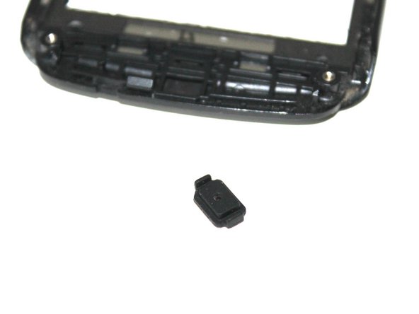

    • Something very easy to forget - remove the tiny rubber gasket for the microphone, and place it in the new front panel
