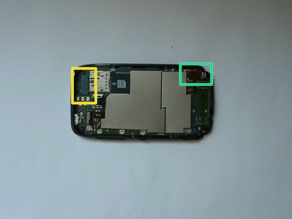

  3. Nokia Lumia 610 Touch screen / Digitizer, LCD Display Replacement: crwdns2935265:03crwdnd2935265:01crwdnd2935265:02crwdne2935265:0 Nokia Lumia 610 Touch screen / Digitizer, LCD Display Replacement: crwdns2935265:03crwdnd2935265:02crwdnd2935265:02crwdne2935265:0
    • The Loudspeaker is on the middle frame.
    • Disconnect the LCD Display flex cable.
    • Disconnect the Touch screen flex cable.

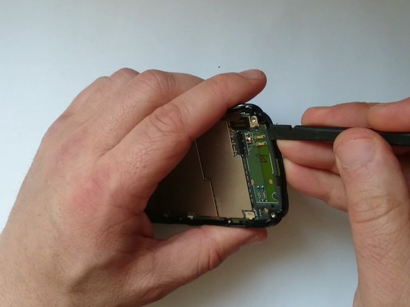

  4. Nokia Lumia 610 Touch screen / Digitizer, LCD Display Replacement: crwdns2935265:04crwdnd2935265:01crwdnd2935265:03crwdne2935265:0 Nokia Lumia 610 Touch screen / Digitizer, LCD Display Replacement: crwdns2935265:04crwdnd2935265:02crwdnd2935265:03crwdne2935265:0 Nokia Lumia 610 Touch screen / Digitizer, LCD Display Replacement: crwdns2935265:04crwdnd2935265:03crwdnd2935265:03crwdne2935265:0
    • The Logic board is held by 2x locking clips at the bottom side.
    • Release it and gently remove it from the front frame.

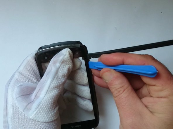

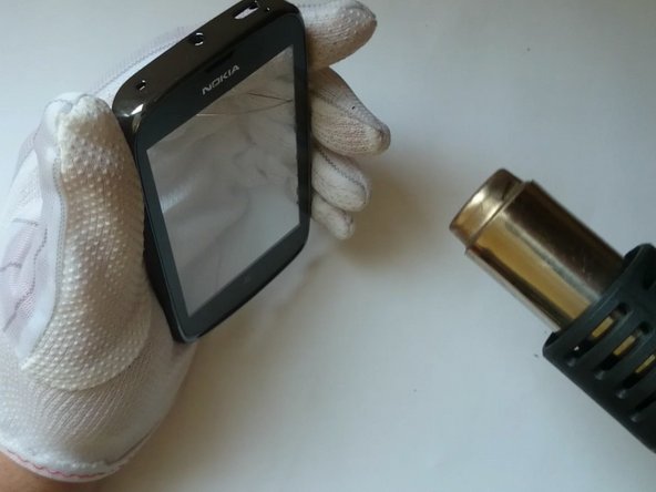

  5. Nokia Lumia 610 Touch screen / Digitizer, LCD Display Replacement: crwdns2935265:05crwdnd2935265:01crwdnd2935265:03crwdne2935265:0 Nokia Lumia 610 Touch screen / Digitizer, LCD Display Replacement: crwdns2935265:05crwdnd2935265:02crwdnd2935265:03crwdne2935265:0 Nokia Lumia 610 Touch screen / Digitizer, LCD Display Replacement: crwdns2935265:05crwdnd2935265:03crwdnd2935265:03crwdne2935265:0
    • Put tape on the glass to not scatter pieces.
    • Worm the glass to melt the adhesive.
    • Use plastic tools to separate the touchscreen from the frame.

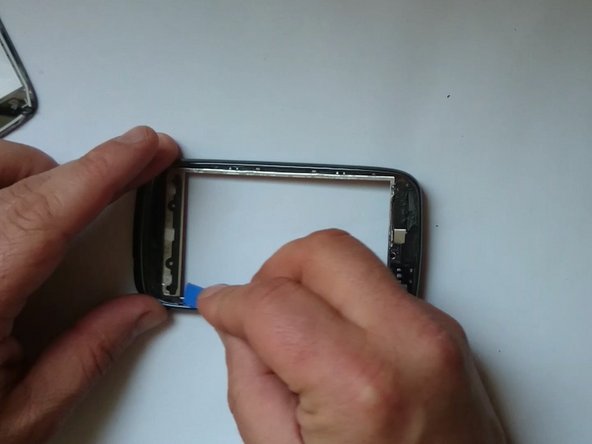

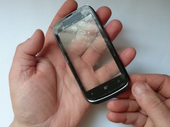

  6. Nokia Lumia 610 Touch screen / Digitizer, LCD Display Replacement: crwdns2935265:06crwdnd2935265:01crwdnd2935265:03crwdne2935265:0 Nokia Lumia 610 Touch screen / Digitizer, LCD Display Replacement: crwdns2935265:06crwdnd2935265:02crwdnd2935265:03crwdne2935265:0 Nokia Lumia 610 Touch screen / Digitizer, LCD Display Replacement: crwdns2935265:06crwdnd2935265:03crwdnd2935265:03crwdne2935265:0
    • After separating, clean up the sticker that remains on the borders.
    • New line.Install the new touchscreen and reassemble the device.
