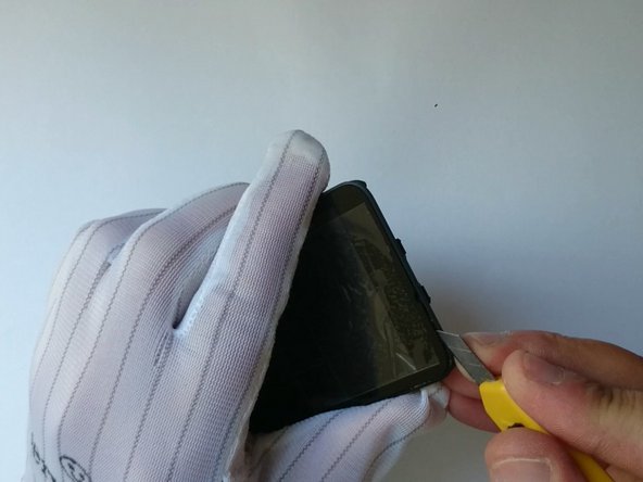

    • If the glass is broken, put some scotch tape to prevent it breake to pieces.
    • Use a hot air to make adhesive tape more soften.
    • For this operation you can use a hairdryer.
    • Use a cutter and make small room to insert a plastic pick.

    • Continue with the separation by using a plastic tools.
    • If necessary, use the hot air again

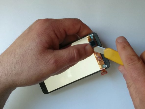

    • Unstuck the Touch screen flex cable from the display.
    • If you have a broken glass, you can cut the touch screen flex cable, otherwise unsolder it careful like in the next step.

    • The display edges are glued to the glass with adhesive tape.
    • Use only thin plastic tools for the separation.

    • Remove the blue sticker.
    • With a soldering iron, remove the touch screen flex cable and install the new one.
    • Put back the blue sticker.
