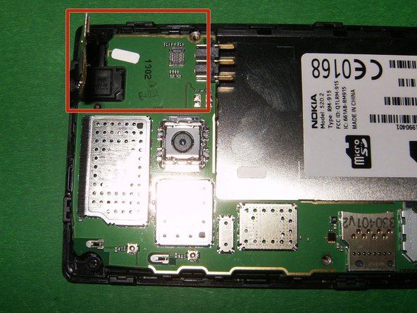

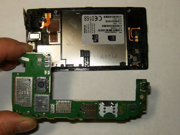

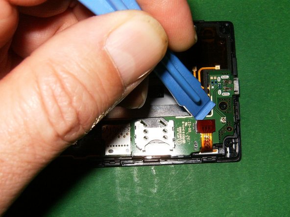

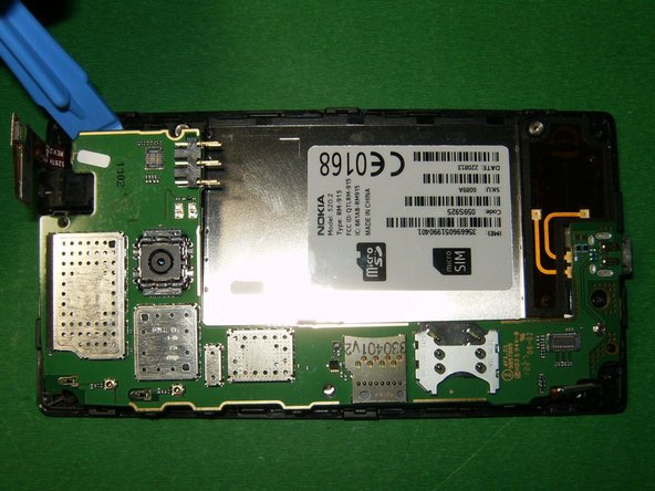

  7. Nokia Lumia 520 and 521 Touch Window Replacement: crwdns2935265:07crwdnd2935265:01crwdnd2935265:03crwdne2935265:0 Nokia Lumia 520 and 521 Touch Window Replacement: crwdns2935265:07crwdnd2935265:02crwdnd2935265:03crwdne2935265:0 Nokia Lumia 520 and 521 Touch Window Replacement: crwdns2935265:07crwdnd2935265:03crwdnd2935265:03crwdne2935265:0
    • Display flex removed from the connector
    • Use an opening tool, or a spudger, to remove the logic board from the case. It is simply held in by two clips.
    • Remove the logic board from the front assembly
