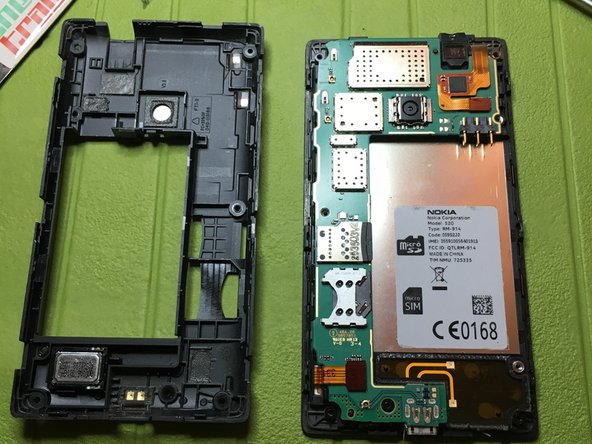

  4. Nokia Lumia 520 Touchscreen  Replacement: crwdns2935265:04crwdnd2935265:01crwdnd2935265:02crwdne2935265:0 Nokia Lumia 520 Touchscreen  Replacement: crwdns2935265:04crwdnd2935265:02crwdnd2935265:02crwdne2935265:0
    • With a thin tool, unhook the central body from the back cover, along the entire profile of the phone

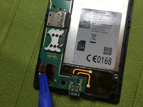

  5. Nokia Lumia 520 Touchscreen  Replacement: crwdns2935265:05crwdnd2935265:01crwdnd2935265:03crwdne2935265:0 Nokia Lumia 520 Touchscreen  Replacement: crwdns2935265:05crwdnd2935265:02crwdnd2935265:03crwdne2935265:0 Nokia Lumia 520 Touchscreen  Replacement: crwdns2935265:05crwdnd2935265:03crwdnd2935265:03crwdne2935265:0
    • Unclip the touchscreen connector
    • Unhook the display connector
    • Unhook the motherboard from the central phone body

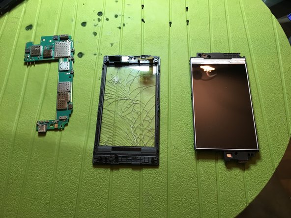

  6. Nokia Lumia 520 Touchscreen  Replacement: crwdns2935265:06crwdnd2935265:01crwdnd2935265:02crwdne2935265:0 Nokia Lumia 520 Touchscreen  Replacement: crwdns2935265:06crwdnd2935265:02crwdnd2935265:02crwdne2935265:0
    • Pull up the central frame from the touchscreen assembly by lifting the clips on the perimeter with a thin tool.

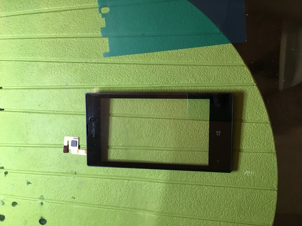

  7. Nokia Lumia 520 Touchscreen  Replacement: crwdns2935265:07crwdnd2935265:01crwdnd2935265:01crwdne2935265:0
    • Remove the light sensor from the old frame with the help of a heat source.
    • Insert the sensor in the new frame.
  8. Nokia Lumia 520 Touchscreen  Replacement: crwdns2935265:08crwdnd2935265:01crwdnd2935265:03crwdne2935265:0 Nokia Lumia 520 Touchscreen  Replacement: crwdns2935265:08crwdnd2935265:02crwdnd2935265:03crwdne2935265:0 Nokia Lumia 520 Touchscreen  Replacement: crwdns2935265:08crwdnd2935265:03crwdnd2935265:03crwdne2935265:0
    • Remove film that protects double-sided adhesive from the new touchscreen glass
    • Insert flat touchscreen into the frame slot and adhere the double sided adhesive to the frame by placing it in the correct position
