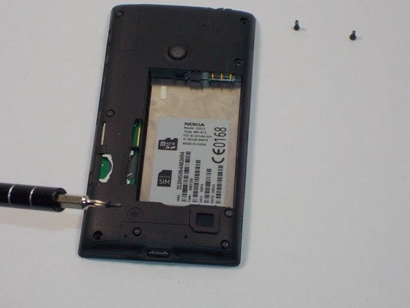

  4. Nokia Lumia 520 Power/Volume Switch Replacement, Power/Volume Switch: crwdns2935265:04crwdnd2935265:01crwdnd2935265:03crwdne2935265:0 Nokia Lumia 520 Power/Volume Switch Replacement, Power/Volume Switch: crwdns2935265:04crwdnd2935265:02crwdnd2935265:03crwdne2935265:0 Nokia Lumia 520 Power/Volume Switch Replacement, Power/Volume Switch: crwdns2935265:04crwdnd2935265:03crwdnd2935265:03crwdne2935265:0
    • Unscrew the eight screws in the body of the phone using the Torx screw driver (T4).
    • Once the screws are removed keep them nearby for convenience when repairing the phone later.

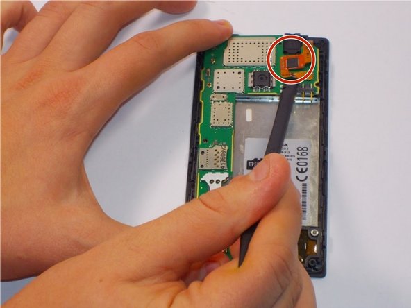

  6. Nokia Lumia 520 Power/Volume Switch Replacement: crwdns2935265:06crwdnd2935265:01crwdnd2935265:02crwdne2935265:0 Nokia Lumia 520 Power/Volume Switch Replacement: crwdns2935265:06crwdnd2935265:02crwdnd2935265:02crwdne2935265:0
    • Using your spudger, carefully unclip the digitizer touch screen cable. Next unclip the display screen cable.

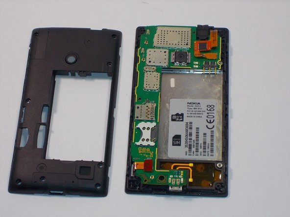

  7. Nokia Lumia 520 Power/Volume Switch Replacement: crwdns2935265:07crwdnd2935265:01crwdnd2935265:02crwdne2935265:0 Nokia Lumia 520 Power/Volume Switch Replacement: crwdns2935265:07crwdnd2935265:02crwdnd2935265:02crwdne2935265:0
    • Gently remove the motherboard with your hands.
    • Flip it over. Then turn it 90 degrees counterclockwise. Ensure the switches (pictured) are facing you.
    • You will see four small switches close to the side of the circuit board.
