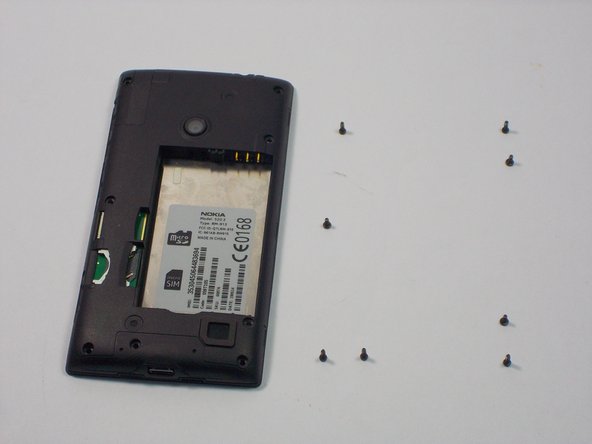

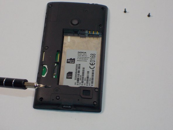

    • Unscrew the 8 screws with a Torx screw driver (T4) and make sure you know what screws went where because they are different.

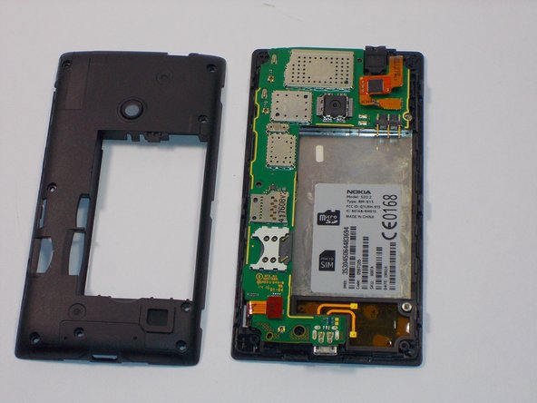

    • Use your plastic spudger to remove the clips on the plastic casing over the motherboard. Note there are 10 clips holding the casing on(3 on the sides, 2 on the top and bottom).

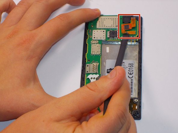

    • Carefully unclip the digitizer touch screen cable and the display screen cable using the spudger.
  7. Nokia Lumia 520 Audio Jack Replacement: crwdns2935265:07crwdnd2935265:01crwdnd2935265:02crwdne2935265:0 Nokia Lumia 520 Audio Jack Replacement: crwdns2935265:07crwdnd2935265:02crwdnd2935265:02crwdne2935265:0
    • Gently remove the motherboard.
  8. Nokia Lumia 520 Audio Jack Replacement: crwdns2935265:08crwdnd2935265:01crwdnd2935265:02crwdne2935265:0 Nokia Lumia 520 Audio Jack Replacement: crwdns2935265:08crwdnd2935265:02crwdnd2935265:02crwdne2935265:0

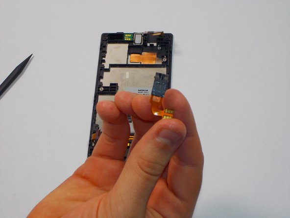

    • Use the plastic spudger and gently remove the audio jack and the flex connector to the audio jack away from the case.
    • You will feel some pressure since the audio jack is held in place with two sided tape.
