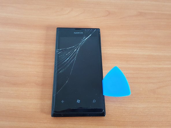

    • Remove the back cover
    • Remove the battery and the sim card

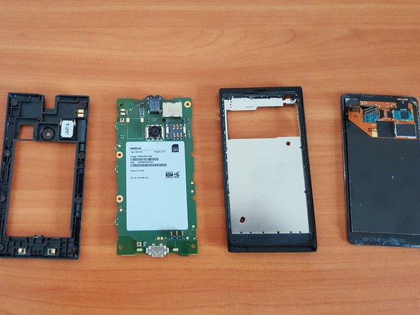

    • Remove the 8 Torx T5 screws
    • Insert a guitar pick between the frame of the phone
    • You have to pry until the frame separates

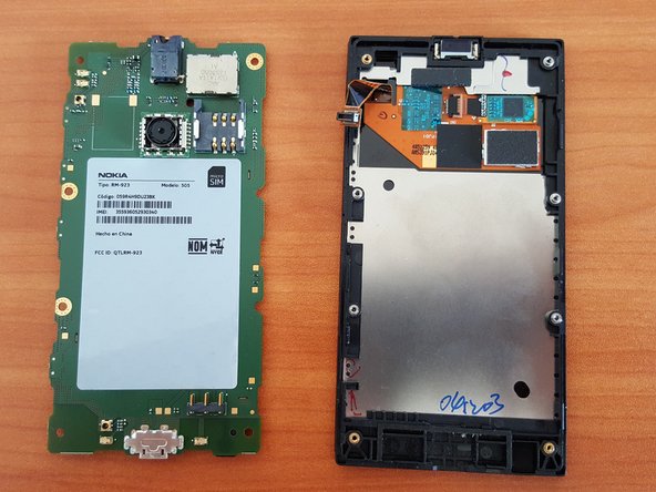

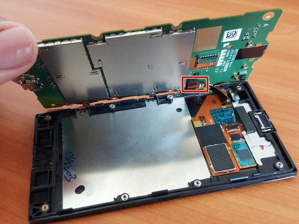

    • Pry on the right side to remove the Motherboard
    • Do not remove it from the whole as it is still connected to the screen
    • remove the cable by pushing it down

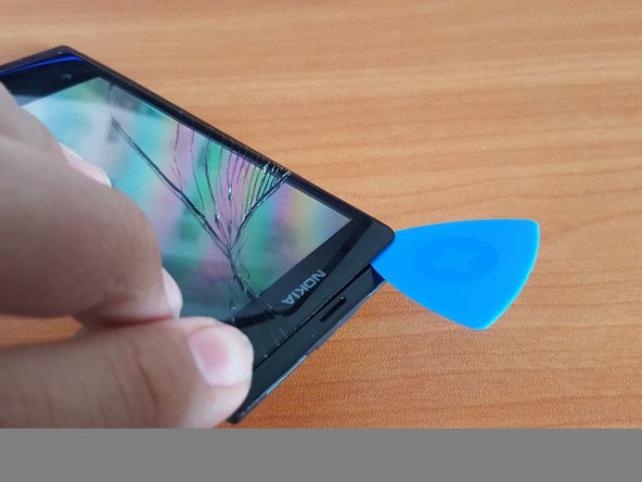

    • to remove the screen we will have to push it from the inside out
    • since we push it, a space will be created between the screen and the frame, there we will put a guitar pick
    • the next thing is to move the pua around the frame to separate the screen
