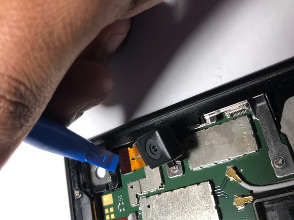

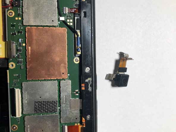

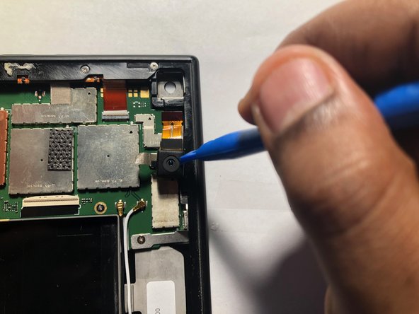

  10. Nokia Lumia 2520 Cameras  Replacement, Cameras: crwdns2935265:010crwdnd2935265:01crwdnd2935265:03crwdne2935265:0 Nokia Lumia 2520 Cameras  Replacement, Cameras: crwdns2935265:010crwdnd2935265:02crwdnd2935265:03crwdne2935265:0 Nokia Lumia 2520 Cameras  Replacement, Cameras: crwdns2935265:010crwdnd2935265:03crwdnd2935265:03crwdne2935265:0
    • Take a PH0 Phillps head screw bit to take the screw out.
    • Take a pry tool and disconnect the ribbon cabe from the logic board
    • Then use a plastic pry tool and take out the front facing camera out of its housing.
    • The front facing camera is clued on so use some force to pry it off.

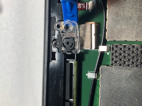

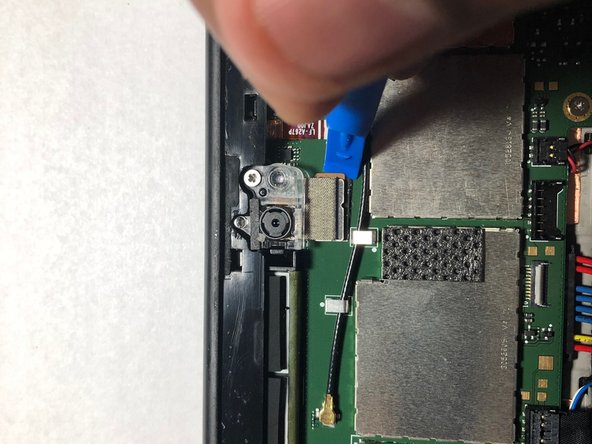

  11. Nokia Lumia 2520 Cameras  Replacement: crwdns2935265:011crwdnd2935265:01crwdnd2935265:03crwdne2935265:0 Nokia Lumia 2520 Cameras  Replacement: crwdns2935265:011crwdnd2935265:02crwdnd2935265:03crwdne2935265:0 Nokia Lumia 2520 Cameras  Replacement: crwdns2935265:011crwdnd2935265:03crwdnd2935265:03crwdne2935265:0
    • Locate the rear facing camera. which is located on the top right side of the case.
    • Take a plastic pry tool to pill the tape and camera from its housing.

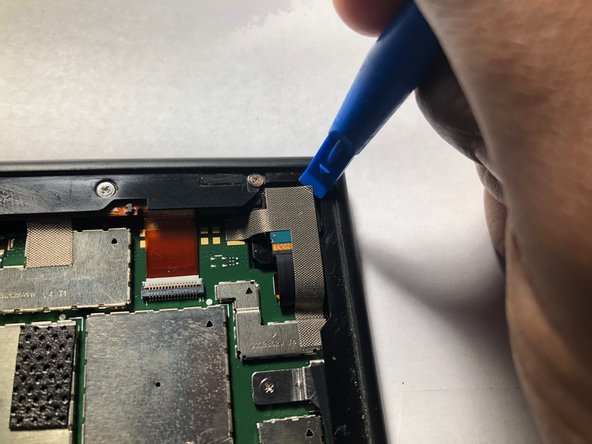

  12. Nokia Lumia 2520 Cameras  Replacement: crwdns2935265:012crwdnd2935265:01crwdnd2935265:03crwdne2935265:0 Nokia Lumia 2520 Cameras  Replacement: crwdns2935265:012crwdnd2935265:02crwdnd2935265:03crwdne2935265:0 Nokia Lumia 2520 Cameras  Replacement: crwdns2935265:012crwdnd2935265:03crwdnd2935265:03crwdne2935265:0
    • Take the pry tool and remove the ribbon cable from the logic board.
