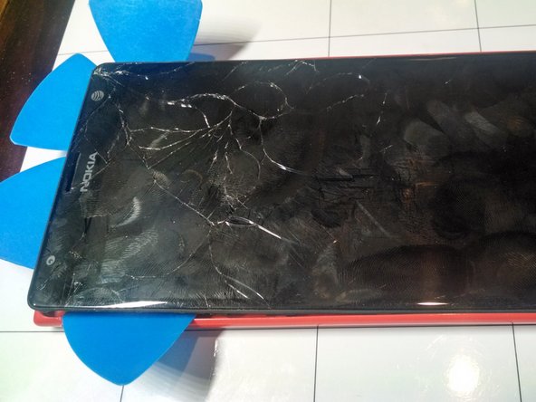

  3. Nokia Lumia 1520 Teardown, Remove the Red Plastic Frame: crwdns2935265:03crwdnd2935265:01crwdnd2935265:03crwdne2935265:0 Nokia Lumia 1520 Teardown, Remove the Red Plastic Frame: crwdns2935265:03crwdnd2935265:02crwdnd2935265:03crwdne2935265:0 Nokia Lumia 1520 Teardown, Remove the Red Plastic Frame: crwdns2935265:03crwdnd2935265:03crwdnd2935265:03crwdne2935265:0
    • Using plastic picks, begin to separate the frame from the internals at the corner of the phone containing the SIM tray.
    • Work around the top of the device placing more picks between the frame and the internals.
    • Once the top is removed from the Plastic frame work down the sides and remove the plastic frame.

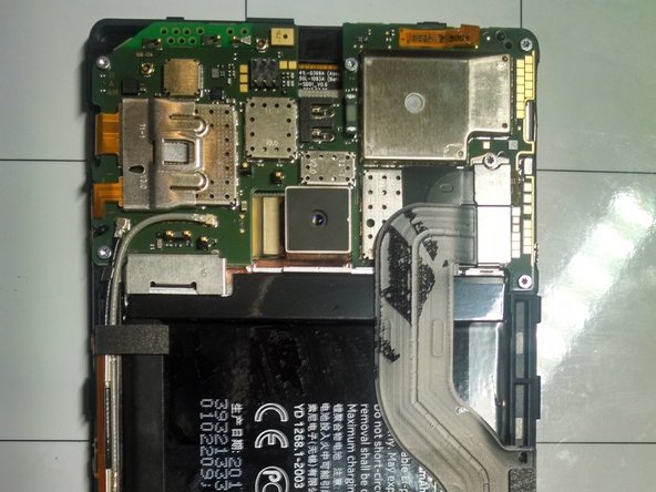

  4. Nokia Lumia 1520 Teardown, First Sight of the Internals: crwdns2935265:04crwdnd2935265:01crwdnd2935265:03crwdne2935265:0 Nokia Lumia 1520 Teardown, First Sight of the Internals: crwdns2935265:04crwdnd2935265:02crwdnd2935265:03crwdne2935265:0 Nokia Lumia 1520 Teardown, First Sight of the Internals: crwdns2935265:04crwdnd2935265:03crwdnd2935265:03crwdne2935265:0
    • With the frame removed we can get a look at the internals.

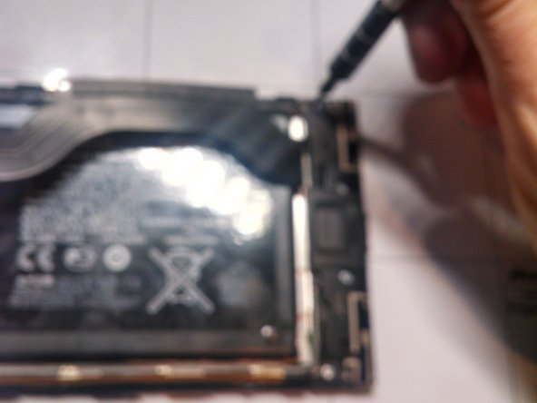

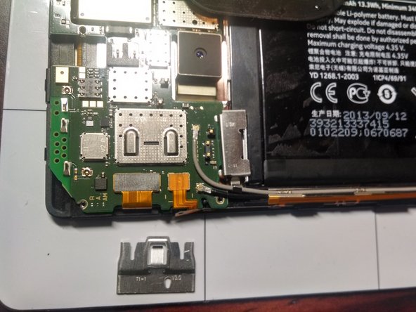

  5. Nokia Lumia 1520 Teardown, Unscrew Motherboard: crwdns2935265:05crwdnd2935265:01crwdnd2935265:01crwdne2935265:0
    • Remove the six T4 screws indicated in the image.
  6. Nokia Lumia 1520 Teardown, Remove Metal Strap: crwdns2935265:06crwdnd2935265:01crwdnd2935265:02crwdne2935265:0 Nokia Lumia 1520 Teardown, Remove Metal Strap: crwdns2935265:06crwdnd2935265:02crwdnd2935265:02crwdne2935265:0
    • LIft up and remove the metal strap that covers the pop connector on the board.
  7. Nokia Lumia 1520 Teardown, Slide Away Metal Strap: crwdns2935265:07crwdnd2935265:01crwdnd2935265:02crwdne2935265:0 Nokia Lumia 1520 Teardown, Slide Away Metal Strap: crwdns2935265:07crwdnd2935265:02crwdnd2935265:02crwdne2935265:0
    • Slide away the other metal strap that covers more pop connectors.
  8. Nokia Lumia 1520 Teardown, Demate Connector: crwdns2935265:08crwdnd2935265:01crwdnd2935265:01crwdne2935265:0
    • Gently lift up on the four pop connectors to demate and remove them from the board.
  9. Nokia Lumia 1520 Teardown, Disconnect Coaxial Cables: crwdns2935265:09crwdnd2935265:01crwdnd2935265:01crwdne2935265:0
    • Remove the two coaxial cables by gently lifting up.
  10. Nokia Lumia 1520 Teardown, Remove the Motherboard: crwdns2935265:010crwdnd2935265:01crwdnd2935265:02crwdne2935265:0 Nokia Lumia 1520 Teardown, Remove the Motherboard: crwdns2935265:010crwdnd2935265:02crwdnd2935265:02crwdne2935265:0
    • The motherboard can now be lifted from the unit.

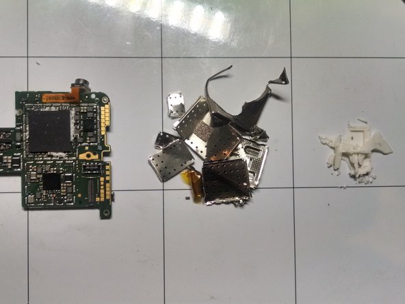

  11. Nokia Lumia 1520 Teardown, Shielding and Thermal Paste Removal: crwdns2935265:011crwdnd2935265:01crwdnd2935265:02crwdne2935265:0 Nokia Lumia 1520 Teardown, Shielding and Thermal Paste Removal: crwdns2935265:011crwdnd2935265:02crwdnd2935265:02crwdne2935265:0
    • The board level shielding was soldered to the board and required prying and breaking to reveal the chips.
    • Once the board level shielding was removed, the silicone thermally conductive rubber was scraped away from the processor.
  12. Nokia Lumia 1520 Teardown, The Motherboard Bares All: crwdns2935265:012crwdnd2935265:01crwdnd2935265:02crwdne2935265:0 Nokia Lumia 1520 Teardown, The Motherboard Bares All: crwdns2935265:012crwdnd2935265:02crwdnd2935265:02crwdne2935265:0
    • Samsung KLMAG2GEAC-B001 HMHB656EU 337
    • Samsung K3QF2F2ODM OGCE 6F63209X 337
    • 405707 D925A4
    • RF7459A F14L10Y
    • SWH GMF81
    • WTR1605L OVV PPV438Z2 AB31801 10

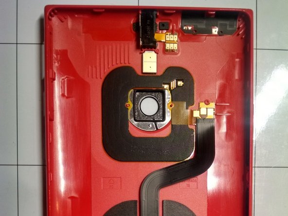

  13. Nokia Lumia 1520 Teardown, Removal of the Antenna Module: crwdns2935265:013crwdnd2935265:01crwdnd2935265:02crwdne2935265:0 Nokia Lumia 1520 Teardown, Removal of the Antenna Module: crwdns2935265:013crwdnd2935265:02crwdnd2935265:02crwdne2935265:0
    • The antenna module is adhered to a daughter board with a soft sticky adhesive.
    • Remove the Antenna module by removing four T4 screws.
  14. Nokia Lumia 1520 Teardown, Removal of the Antenna Module: crwdns2935265:014crwdnd2935265:01crwdnd2935265:03crwdne2935265:0 Nokia Lumia 1520 Teardown, Removal of the Antenna Module: crwdns2935265:014crwdnd2935265:02crwdnd2935265:03crwdne2935265:0 Nokia Lumia 1520 Teardown, Removal of the Antenna Module: crwdns2935265:014crwdnd2935265:03crwdnd2935265:03crwdne2935265:0
    • Remove the coaxial antenna cables by gently prying them up.
    • The Daughterboard and flex cable come out of the phone easily.
    • At this point we can see the USB connector is soldered to the board making replacement of this component expensive.

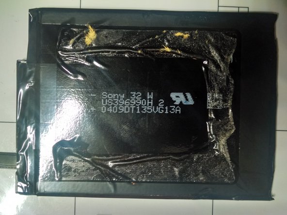

  15. Nokia Lumia 1520 Teardown, Battery Removal: crwdns2935265:015crwdnd2935265:01crwdnd2935265:03crwdne2935265:0 Nokia Lumia 1520 Teardown, Battery Removal: crwdns2935265:015crwdnd2935265:02crwdnd2935265:03crwdne2935265:0 Nokia Lumia 1520 Teardown, Battery Removal: crwdns2935265:015crwdnd2935265:03crwdnd2935265:03crwdne2935265:0
    • The battery is adhered quite strongly to the assembly.
    • A couple rounds of hot iOpener application followed by aggressive prying with plastic picks and metal tools was required to remove the battery.
  16. Nokia Lumia 1520 Teardown, Views of The Battery and Bare Touchscreen Assembly: crwdns2935265:016crwdnd2935265:01crwdnd2935265:02crwdne2935265:0 Nokia Lumia 1520 Teardown, Views of The Battery and Bare Touchscreen Assembly: crwdns2935265:016crwdnd2935265:02crwdnd2935265:02crwdne2935265:0
    • Views of The Battery and Bare Touchscreen Assembly

It may be prudent to add a note to use the picks directly next to the back frame rather then just say from the corner. In my efforts to remove the back, I decimated the screen and now have to get a new one….
