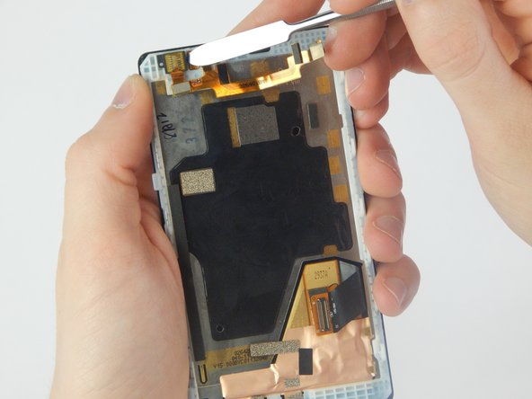

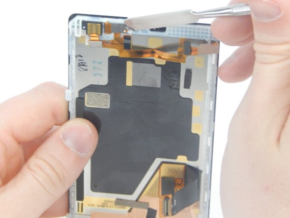

  3. Nokia Lumia 1020 Front-Facing Camera Replacement: crwdns2935265:03crwdnd2935265:01crwdnd2935265:03crwdne2935265:0 Nokia Lumia 1020 Front-Facing Camera Replacement: crwdns2935265:03crwdnd2935265:02crwdnd2935265:03crwdne2935265:0 Nokia Lumia 1020 Front-Facing Camera Replacement: crwdns2935265:03crwdnd2935265:03crwdnd2935265:03crwdne2935265:0
    • Wedge a spudger underneath the silver rectangle in the upper right corner until it pops off the back of the phone.
  4. Nokia Lumia 1020 Front-Facing Camera Replacement: crwdns2935265:04crwdnd2935265:01crwdnd2935265:03crwdne2935265:0 Nokia Lumia 1020 Front-Facing Camera Replacement: crwdns2935265:04crwdnd2935265:02crwdnd2935265:03crwdne2935265:0 Nokia Lumia 1020 Front-Facing Camera Replacement: crwdns2935265:04crwdnd2935265:03crwdnd2935265:03crwdne2935265:0
    • Wedge a spudger underneath the silver rectangle in the lower left corner until it pops off the back of the phone.
    • Completely remove the screen from the back of the phone.

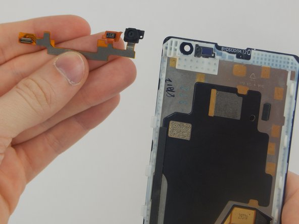

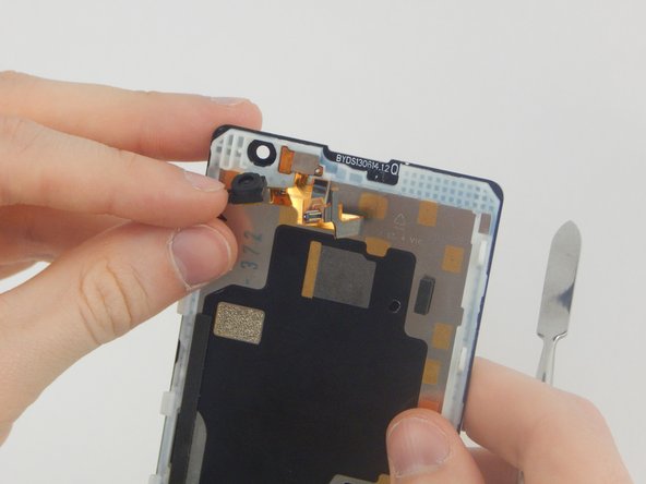

  5. Nokia Lumia 1020 Front-Facing Camera Replacement, Front-Facing Camera: crwdns2935265:05crwdnd2935265:01crwdnd2935265:03crwdne2935265:0 Nokia Lumia 1020 Front-Facing Camera Replacement, Front-Facing Camera: crwdns2935265:05crwdnd2935265:02crwdnd2935265:03crwdne2935265:0 Nokia Lumia 1020 Front-Facing Camera Replacement, Front-Facing Camera: crwdns2935265:05crwdnd2935265:03crwdnd2935265:03crwdne2935265:0
    • Wedge a spudger underneath front-facing camera on the upper left corner of the screen. Pry upwards until it pops up to the right.
  6. Nokia Lumia 1020 Front-Facing Camera Replacement: crwdns2935265:06crwdnd2935265:01crwdnd2935265:03crwdne2935265:0 Nokia Lumia 1020 Front-Facing Camera Replacement: crwdns2935265:06crwdnd2935265:02crwdnd2935265:03crwdne2935265:0 Nokia Lumia 1020 Front-Facing Camera Replacement: crwdns2935265:06crwdnd2935265:03crwdnd2935265:03crwdne2935265:0
    • Wedge a spudger underneath the silver rectangle to the right of the front-facing camera. Pry upwards until it pops off.
    • Remove the camera.
