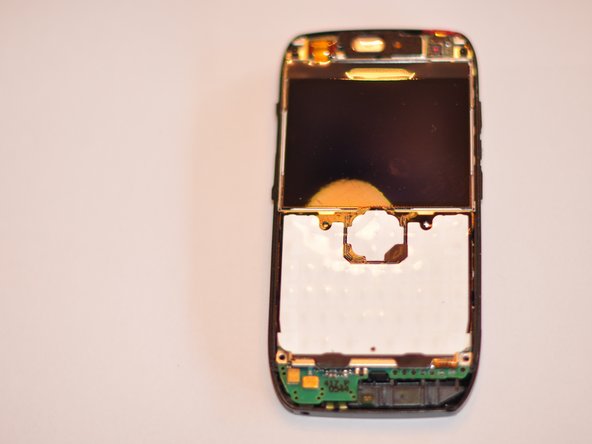

      • Using Torx number 4 unscrew the four 0.5mm screws.
    3. Nokia E71x Camera Replacement: crwdns2935265:03crwdnd2935265:01crwdnd2935265:01crwdne2935265:0

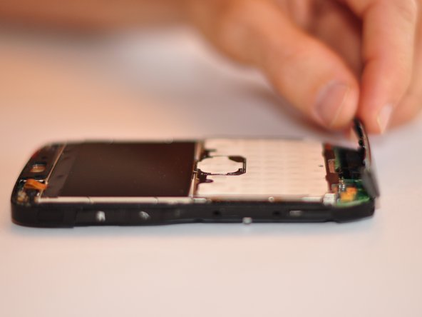

      • Push in four clips to detach the body.
    4. Nokia E71x Camera Replacement: crwdns2935265:04crwdnd2935265:01crwdnd2935265:03crwdne2935265:0 Nokia E71x Camera Replacement: crwdns2935265:04crwdnd2935265:02crwdnd2935265:03crwdne2935265:0 Nokia E71x Camera Replacement: crwdns2935265:04crwdnd2935265:03crwdnd2935265:03crwdne2935265:0

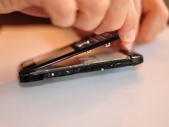

      • Separate the body into two pieces.
      • Be careful not to damage the screen or body. Some force will be needed to separate the body.

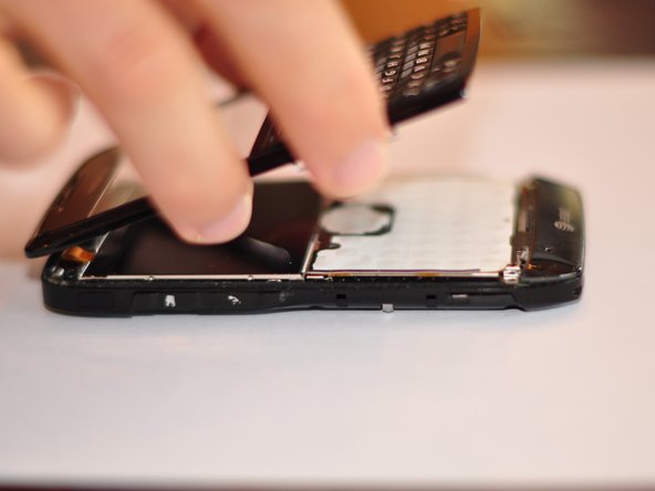

      • Remove the bottom piece that is clipped on.
      • Some force will need to be exerted to remove the clip.

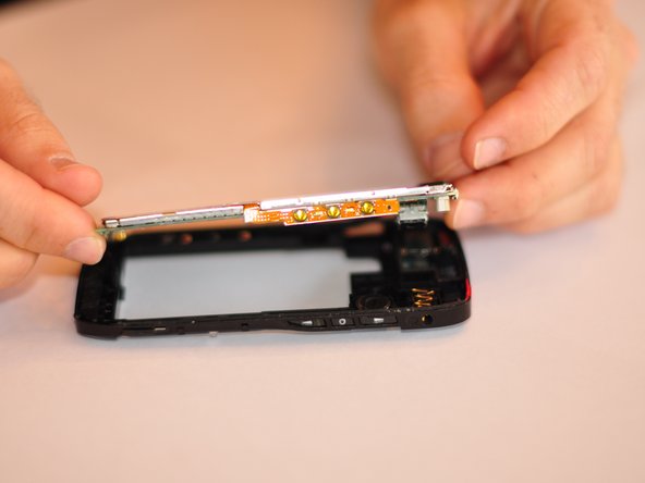

      • Using Torx number 4 unscrew the two 0.7 mm screws at the top of the device.
    7. Nokia E71x Camera Replacement: crwdns2935265:07crwdnd2935265:01crwdnd2935265:02crwdne2935265:0 Nokia E71x Camera Replacement: crwdns2935265:07crwdnd2935265:02crwdnd2935265:02crwdne2935265:0
      • Once screws are removed detach back of phone from the motherboard.
      • This will require some force and maneuvering. Be careful not to break phone back or motherboard.

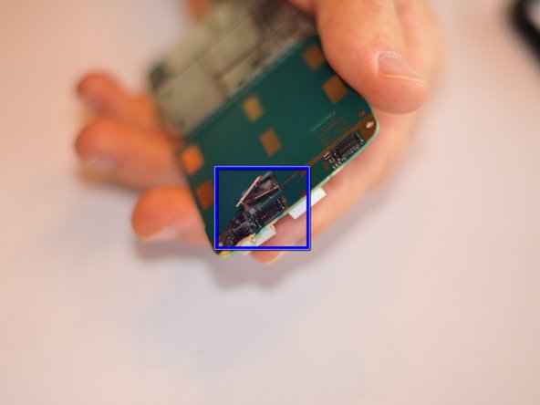

      • Replace motherboard, ensure that replacement has the same serial number.
    1. Nokia E71x Camera Replacement, Camera: crwdns2935265:09crwdnd2935265:01crwdnd2935265:02crwdne2935265:0 Nokia E71x Camera Replacement, Camera: crwdns2935265:09crwdnd2935265:02crwdnd2935265:02crwdne2935265:0
      • Carefully un-clip camera ribbon. Install new camera.
