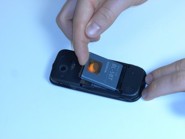

    • Place a finger or plastic opening tool in the gap between the battery and the phone.
    • Gently lift the battery out.

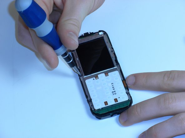

    • Locate the six screws positions along the edges of the motherboard.
    • Unscrew the six screws using the Torx 5 screwdriver (see Introduction for description of a Torx 5 screwdriver).
    • CAUTION! Place the screws in a secure location.
