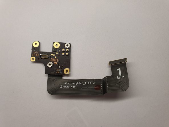

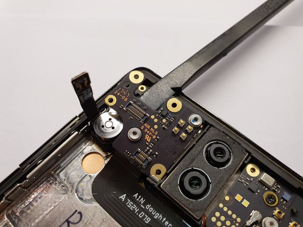

  4. Nokia 8 Sirocco Teardown, Daughter board: crwdns2935265:04crwdnd2935265:01crwdnd2935265:03crwdne2935265:0 Nokia 8 Sirocco Teardown, Daughter board: crwdns2935265:04crwdnd2935265:02crwdnd2935265:03crwdne2935265:0 Nokia 8 Sirocco Teardown, Daughter board: crwdns2935265:04crwdnd2935265:03crwdnd2935265:03crwdne2935265:0
    • Disconnect volume and power button connector
    • Disconnect connector on motherboard
    • Pry off the daughter board

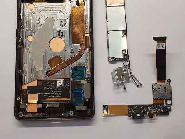

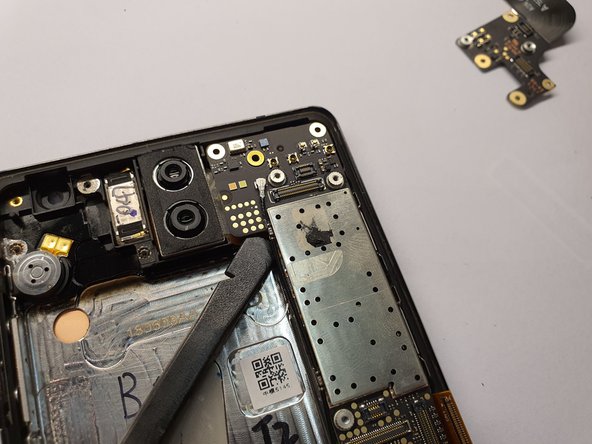

  5. Nokia 8 Sirocco Teardown, Motherboard: crwdns2935265:05crwdnd2935265:01crwdnd2935265:03crwdne2935265:0 Nokia 8 Sirocco Teardown, Motherboard: crwdns2935265:05crwdnd2935265:02crwdnd2935265:03crwdne2935265:0 Nokia 8 Sirocco Teardown, Motherboard: crwdns2935265:05crwdnd2935265:03crwdnd2935265:03crwdne2935265:0
    • There are 2 screws
    • 1 longer black screw
    • 1 standoff screw
    • After taking the screws off, you can disconnect antenna coaxial cables
    • Now you can take motherboard off
    • Make sure to push SIM-eject pin out first
  6. Nokia 8 Sirocco Teardown, Charging board: crwdns2935265:06crwdnd2935265:01crwdnd2935265:02crwdne2935265:0 Nokia 8 Sirocco Teardown, Charging board: crwdns2935265:06crwdnd2935265:02crwdnd2935265:02crwdne2935265:0
    • Charging board is held down with 2 screws
    • 1 black screw
    • 1 golden screw
    • After taking the screws off, charging board is free
    • And now you are done, repeat steps backward to put everything back together
