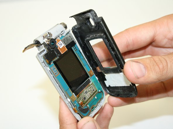

  6. Nokia 6133 External/Main LCD Replacement, External/Main LCD: crwdns2935265:06crwdnd2935265:01crwdnd2935265:02crwdne2935265:0 Nokia 6133 External/Main LCD Replacement, External/Main LCD: crwdns2935265:06crwdnd2935265:02crwdnd2935265:02crwdne2935265:0
    • Using an iPod opening tool, pry open the case that houses the LCD screens by inserting it at the bottom as shown.
    • VERY FRAGILE!! Don't press hard on either side of the LED.
    • Run the tool all along the edge between the darker front case and silver back.
    • Rather difficult to open this part, be careful not to compromise the screens.

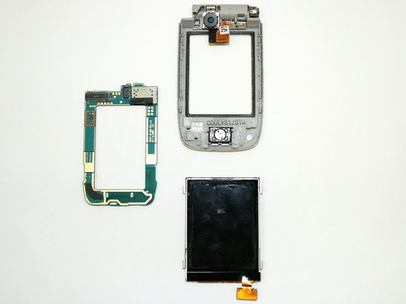

  7. Nokia 6133 External/Main LCD Replacement: crwdns2935265:07crwdnd2935265:01crwdnd2935265:02crwdne2935265:0 Nokia 6133 External/Main LCD Replacement: crwdns2935265:07crwdnd2935265:02crwdnd2935265:02crwdne2935265:0
    • Remove the first flex-wire connection by inserting your thumbnail directly underneath the connection as shown. Will pry off easily.
    • This flex-wire connects the LCD logic board to the main logic board removed earlier.
    • Remove the two other flex-wire connections at the top and bottom of the LCD logic board. Pry up on the respective connections as shown.
    • Square LCD logic board will detach now.

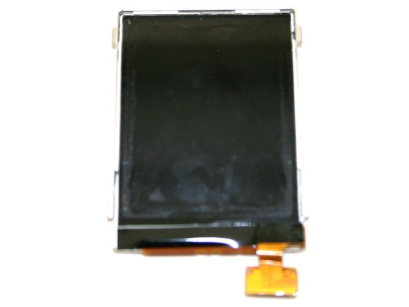

  8. Nokia 6133 External/Main LCD Replacement: crwdns2935265:08crwdnd2935265:01crwdnd2935265:03crwdne2935265:0 Nokia 6133 External/Main LCD Replacement: crwdns2935265:08crwdnd2935265:02crwdnd2935265:03crwdne2935265:0 Nokia 6133 External/Main LCD Replacement: crwdns2935265:08crwdnd2935265:03crwdnd2935265:03crwdne2935265:0
    • Pry back the associated tabs using your thumbnail or an iPod opening tool by pulling them away from the LCD panel.
    • LCD can now be removed easily.
    • To clean use any multipurpose lens cleaner and a soft cloth. DO NOT get lens cleaner on any electronic component!
    • Shown:
    • LCD (Main display side)
    • LCD logic board
    • Case that holds above components and camera.
