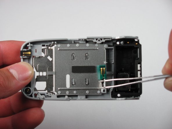

  11. Nokia 6086 Vibrator Replacement, Vibrator: crwdns2935265:011crwdnd2935265:01crwdnd2935265:03crwdne2935265:0 Nokia 6086 Vibrator Replacement, Vibrator: crwdns2935265:011crwdnd2935265:02crwdnd2935265:03crwdne2935265:0 Nokia 6086 Vibrator Replacement, Vibrator: crwdns2935265:011crwdnd2935265:03crwdnd2935265:03crwdne2935265:0
    • Remove the logic board from the bottom casing.
  12. Nokia 6086 Vibrator Replacement: crwdns2935265:012crwdnd2935265:01crwdnd2935265:01crwdne2935265:0
    • The logic board should be fully detached from the phone.
    • The turquoise colored vibrator should now be visible.
  13. Nokia 6086 Vibrator Replacement: crwdns2935265:013crwdnd2935265:01crwdnd2935265:02crwdne2935265:0 Nokia 6086 Vibrator Replacement: crwdns2935265:013crwdnd2935265:02crwdnd2935265:02crwdne2935265:0
    • Place the tweezers at the base of the vibrator.
    • Squeeze the tweezers while simultaneously lifting them up to remove the vibrator.
  14. Nokia 6086 Vibrator Replacement: crwdns2935265:014crwdnd2935265:01crwdnd2935265:01crwdne2935265:0
    • The vibrator should be detached from the phone.
