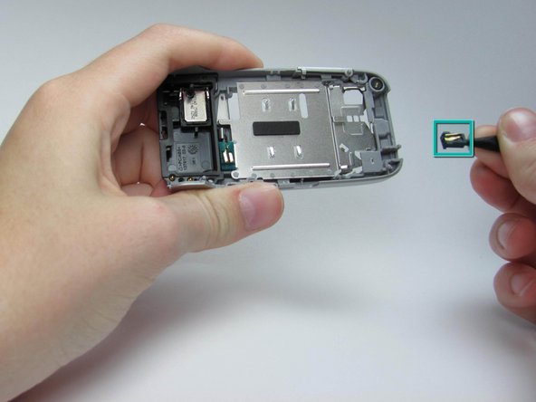

  11. Nokia 6086 Headphone Port Replacement, Headphone Port: crwdns2935265:011crwdnd2935265:01crwdnd2935265:01crwdne2935265:0
    • Turn the phone so that the back section is facing forward.
    • Locate the black headphone port at the bottom of the phone.
  12. Nokia 6086 Headphone Port Replacement: crwdns2935265:012crwdnd2935265:01crwdnd2935265:01crwdne2935265:0
    • Grip the headphone port with the tweezers.
    • Lift the headphone port out of the phone using the tweezers.
  13. Nokia 6086 Headphone Port Replacement: crwdns2935265:013crwdnd2935265:01crwdnd2935265:02crwdne2935265:0 Nokia 6086 Headphone Port Replacement: crwdns2935265:013crwdnd2935265:02crwdnd2935265:02crwdne2935265:0
    • The headphone port should be fully detached from the phone.
