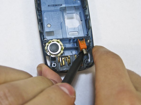

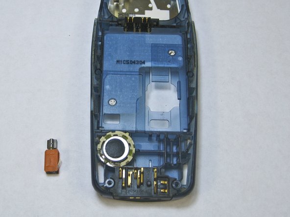

  10. Nokia 6010 vibrator motor replacement, Vibrator: crwdns2935265:010crwdnd2935265:01crwdnd2935265:03crwdne2935265:0 Nokia 6010 vibrator motor replacement, Vibrator: crwdns2935265:010crwdnd2935265:02crwdnd2935265:03crwdne2935265:0 Nokia 6010 vibrator motor replacement, Vibrator: crwdns2935265:010crwdnd2935265:03crwdnd2935265:03crwdne2935265:0
    • Insert a spudger beneath the metallic shaft of the vibrator and pry it away from the phone.
    • The vibrator is the small orange box located near the bottom of the phone.
