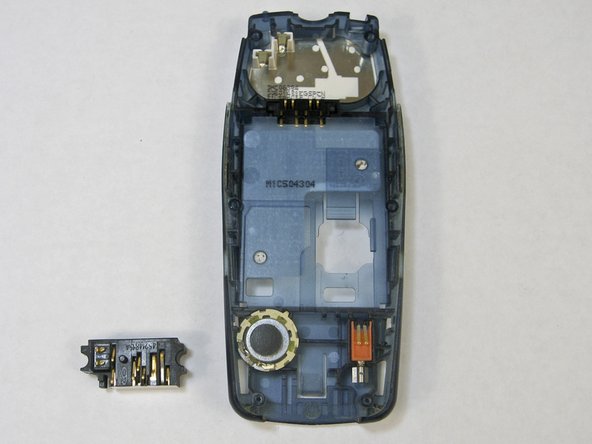

  10. Nokia 6010 Charger Connector Replacement, Charger Connector: crwdns2935265:010crwdnd2935265:01crwdnd2935265:03crwdne2935265:0 Nokia 6010 Charger Connector Replacement, Charger Connector: crwdns2935265:010crwdnd2935265:02crwdnd2935265:03crwdne2935265:0 Nokia 6010 Charger Connector Replacement, Charger Connector: crwdns2935265:010crwdnd2935265:03crwdnd2935265:03crwdne2935265:0
    • Insert a spudger tool between the phone casing and the charger connector.
    • Pry the key away from the phone gently.
    • Be careful not to bend the metal leads while handling the power key.
