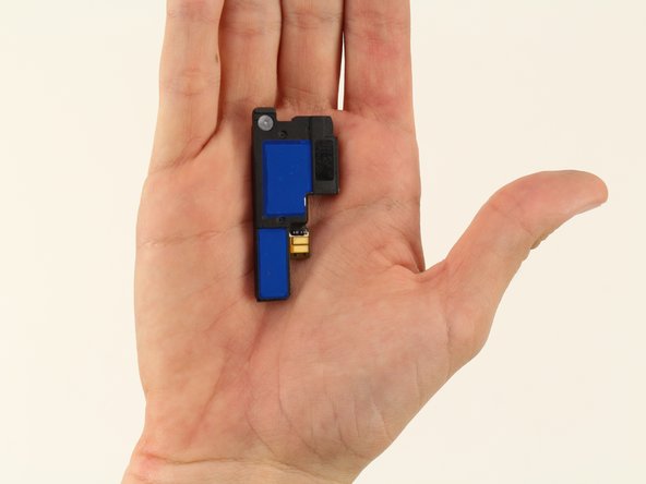

  21. Nokia 6 Vibrator Replacement, Loudspeaker: crwdns2935265:021crwdnd2935265:01crwdnd2935265:02crwdne2935265:0 Nokia 6 Vibrator Replacement, Loudspeaker: crwdns2935265:021crwdnd2935265:02crwdnd2935265:02crwdne2935265:0
    • Use a spudger to remove the loudspeaker from the phone.
  22. Nokia 6 Vibrator Replacement, Vibrator: crwdns2935265:022crwdnd2935265:01crwdnd2935265:02crwdne2935265:0 Nokia 6 Vibrator Replacement, Vibrator: crwdns2935265:022crwdnd2935265:02crwdnd2935265:02crwdne2935265:0
