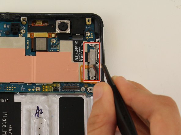

  9. Nokia 6 Rear-Facing Camera Replacement, Home Button Assembly: crwdns2935265:09crwdnd2935265:01crwdnd2935265:01crwdne2935265:0
    • Disconnect the battery connector with a spudger.
  10. Nokia 6 Rear-Facing Camera Replacement: crwdns2935265:010crwdnd2935265:01crwdnd2935265:02crwdne2935265:0 Nokia 6 Rear-Facing Camera Replacement: crwdns2935265:010crwdnd2935265:02crwdnd2935265:02crwdne2935265:0
    • Use a Phillips #00 screwdriver to remove the 1.2 mm x 2.2 mm screw in the upper hand corner of the phone.
    • Use tweezers to remove the bracket.

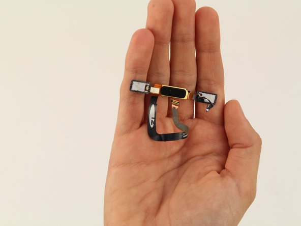

  11. Nokia 6 Rear-Facing Camera Replacement: crwdns2935265:011crwdnd2935265:01crwdnd2935265:02crwdne2935265:0 Nokia 6 Rear-Facing Camera Replacement: crwdns2935265:011crwdnd2935265:02crwdnd2935265:02crwdne2935265:0
    • Detach the cable with the black nylon spudger.
    • Detach the home button and remove it from the device.

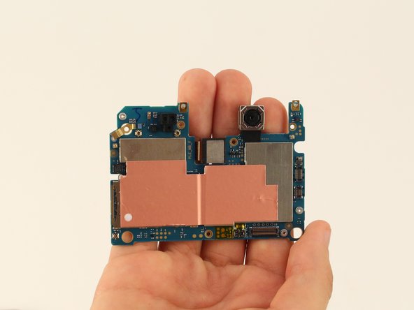

  14. Nokia 6 Rear-Facing Camera Replacement, Motherboard: crwdns2935265:014crwdnd2935265:01crwdnd2935265:02crwdne2935265:0 Nokia 6 Rear-Facing Camera Replacement, Motherboard: crwdns2935265:014crwdnd2935265:02crwdnd2935265:02crwdne2935265:0
  15. Nokia 6 Rear-Facing Camera Replacement: crwdns2935265:015crwdnd2935265:01crwdnd2935265:03crwdne2935265:0 Nokia 6 Rear-Facing Camera Replacement: crwdns2935265:015crwdnd2935265:02crwdnd2935265:03crwdne2935265:0 Nokia 6 Rear-Facing Camera Replacement: crwdns2935265:015crwdnd2935265:03crwdnd2935265:03crwdne2935265:0
    • Detach the two cables with the spudger.
    • Detach the cable with a pair of tweezers.
    • Be careful when detaching the cables, make sure to not completely remove the cables from the phone!
  16. Nokia 6 Rear-Facing Camera Replacement: crwdns2935265:016crwdnd2935265:01crwdnd2935265:01crwdne2935265:0
    • Remove six screws.
    • Two of these screws are 1.0 mm x 1.4 mm and need to be removed by a Phillips #000 screwdriver.
    • The remaining four screws are 1.2 mm x 2.2 mm and are removed by a Phillips #00 screwdriver.
  17. Nokia 6 Rear-Facing Camera Replacement: crwdns2935265:017crwdnd2935265:01crwdnd2935265:02crwdne2935265:0 Nokia 6 Rear-Facing Camera Replacement: crwdns2935265:017crwdnd2935265:02crwdnd2935265:02crwdne2935265:0
    • Remove the motherboard from the Nokia 6 with the spudger.
    • Be careful because the motherboard is fragile. Wiggle it gently to remove it.

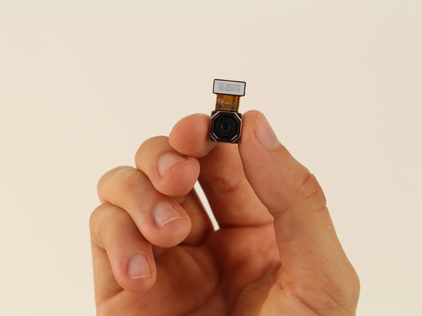

  18. Nokia 6 Rear-Facing Camera Replacement, Rear-Facing Camera: crwdns2935265:018crwdnd2935265:01crwdnd2935265:01crwdne2935265:0
    • Turn the motherboard around to see the rear camera.
  19. Nokia 6 Rear-Facing Camera Replacement: crwdns2935265:019crwdnd2935265:01crwdnd2935265:02crwdne2935265:0 Nokia 6 Rear-Facing Camera Replacement: crwdns2935265:019crwdnd2935265:02crwdnd2935265:02crwdne2935265:0
    • Remove the rear camera with the spudger.
