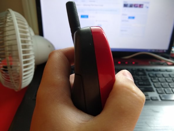

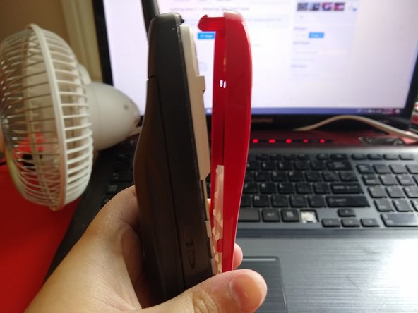

    • Find the tab at the top of the phone and press down with your fingernail or the flat end of a spudger
  2. Nokia 5165 Front Cover Replacement: crwdns2935265:02crwdnd2935265:01crwdnd2935265:03crwdne2935265:0 Nokia 5165 Front Cover Replacement: crwdns2935265:02crwdnd2935265:02crwdnd2935265:03crwdne2935265:0 Nokia 5165 Front Cover Replacement: crwdns2935265:02crwdnd2935265:03crwdnd2935265:03crwdne2935265:0
    • The top of the cover should pop out a little bit, pull the top of the cover out and the cover should come off

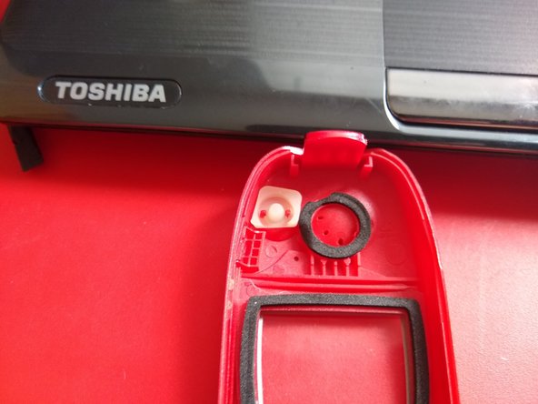

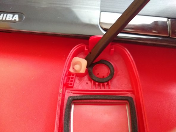

    • Remove the power button with the flat end of a spudger by getting the spudger under the button and pulling it up by the red tabs

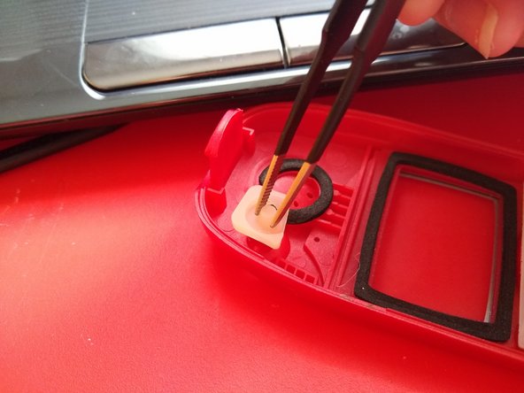

    • Put the number pad into the new cover and push it down

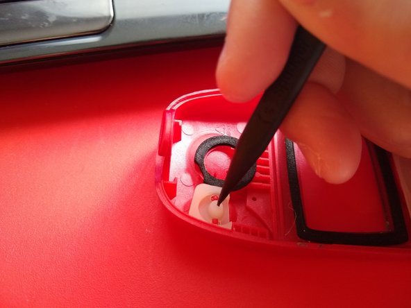

    • For the power button, I recommend using blunt nose tweezers to put the button in with the slope on the top of the button going down towards the speaker hole, then using a spudger to push it in
    • Using pointed tweezers can put holes in the power button and possibly break the button, only use blunt nose tweezers
