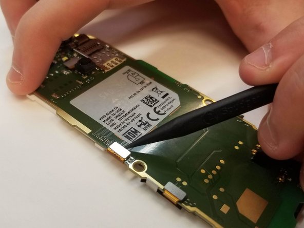

    1. Nokia 3310 3G Screen Replacement, Screen: crwdns2935265:05crwdnd2935265:01crwdnd2935265:03crwdne2935265:0 Nokia 3310 3G Screen Replacement, Screen: crwdns2935265:05crwdnd2935265:02crwdnd2935265:03crwdne2935265:0 Nokia 3310 3G Screen Replacement, Screen: crwdns2935265:05crwdnd2935265:03crwdnd2935265:03crwdne2935265:0
      • With the motherboard removed, the only thing holding the screen into place is the snap plug on the back of the motherboard.
      • Using a spudger, leverage the top snap up to disconnect it (photo shows motherboard rotated 90 degrees counterclockwise).
