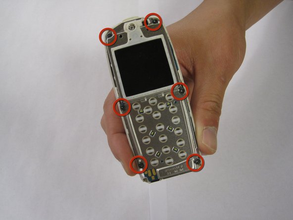

  5. Nokia 3120 Speaker Replacement: crwdns2935265:05crwdnd2935265:01crwdnd2935265:02crwdne2935265:0 Nokia 3120 Speaker Replacement: crwdns2935265:05crwdnd2935265:02crwdnd2935265:02crwdne2935265:0
    • Once the keypad has been removed, unscrew the 6 exposed screws on the front of the phone.
  6. Nokia 3120 Speaker Replacement: crwdns2935265:06crwdnd2935265:01crwdnd2935265:01crwdne2935265:0
    • Once all the screws have been removed, the front part of the phone should be removable from the rest of the phone.
