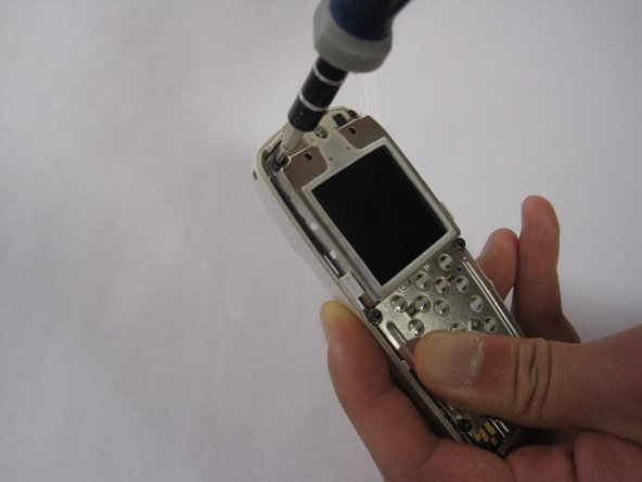

      • Once the cover plate has been removed, the keypad should easily pop out.
    2. Nokia 3120 Liquid Crystal Display (LCD) Replacement: crwdns2935265:05crwdnd2935265:01crwdnd2935265:02crwdne2935265:0 Nokia 3120 Liquid Crystal Display (LCD) Replacement: crwdns2935265:05crwdnd2935265:02crwdnd2935265:02crwdne2935265:0
      • Using a screwdriver, remove the 6, 7 mm Torx-head screws on the front of the phone.
    3. Nokia 3120 Liquid Crystal Display (LCD) Replacement: crwdns2935265:06crwdnd2935265:01crwdnd2935265:01crwdne2935265:0
      • Once the screws have been removed, the front plate of the phone should be removed, exposing the inside electronic components of the phone.
