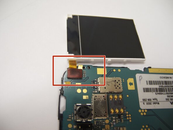

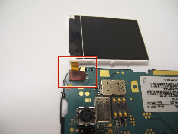

    6. Nokia 2630b Screen / Front Case Replacement: crwdns2935265:08crwdnd2935265:01crwdnd2935265:02crwdne2935265:0 Nokia 2630b Screen / Front Case Replacement: crwdns2935265:08crwdnd2935265:02crwdnd2935265:02crwdne2935265:0
      • The screen is attached to the motherboard by an orange ribbon.
      • Carefully detach the ribbon from the motherboard using your fingers.
    7. Nokia 2630b Screen / Front Case Replacement: crwdns2935265:09crwdnd2935265:01crwdnd2935265:01crwdne2935265:0
      • Reattach new screen by connecting the orange ribbon to the computer chip.
