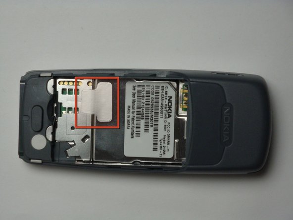

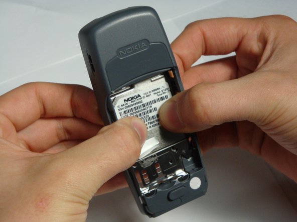

  8. Nokia 2128i Power Unit Replacement, Power Unit: crwdns2935265:08crwdnd2935265:01crwdnd2935265:03crwdne2935265:0 Nokia 2128i Power Unit Replacement, Power Unit: crwdns2935265:08crwdnd2935265:02crwdnd2935265:03crwdne2935265:0 Nokia 2128i Power Unit Replacement, Power Unit: crwdns2935265:08crwdnd2935265:03crwdnd2935265:03crwdne2935265:0

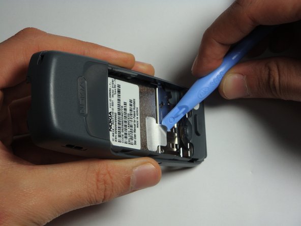

    • Flip phone over and find the sticker that holds the metallic plating together with the phone's case.
    • Pry off the portion of the sticker that is attached to the phone's case. Do not worry about removing the sticker from the metallic plate.

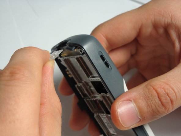

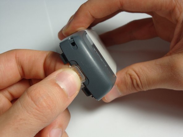

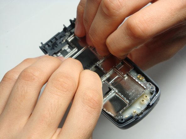

  9. Nokia 2128i Power Unit Replacement: crwdns2935265:09crwdnd2935265:01crwdnd2935265:03crwdne2935265:0 Nokia 2128i Power Unit Replacement: crwdns2935265:09crwdnd2935265:02crwdnd2935265:03crwdne2935265:0 Nokia 2128i Power Unit Replacement: crwdns2935265:09crwdnd2935265:03crwdnd2935265:03crwdne2935265:0
    • Locate the small hook that holds the metallic plate and phone case together on the front side of the phone
    • Place your thumbs on the backside of the metallic plate.
    • Stretch phone casing outward to detach hook from metallic plating. Simultaneously push metallic plate outward to remove.

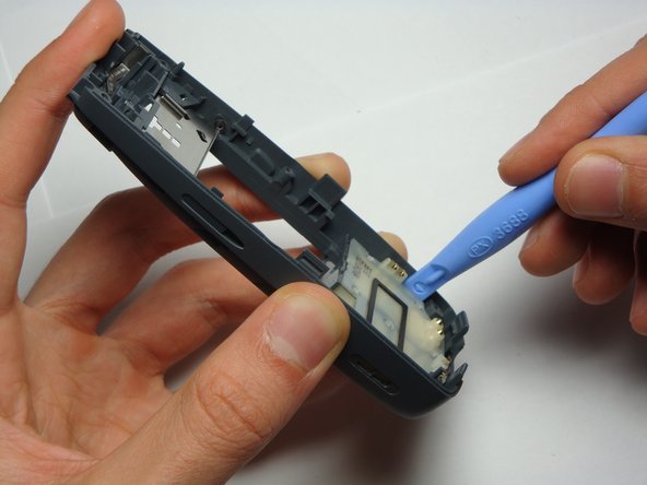

  10. Nokia 2128i Power Unit Replacement: crwdns2935265:010crwdnd2935265:01crwdnd2935265:03crwdne2935265:0 Nokia 2128i Power Unit Replacement: crwdns2935265:010crwdnd2935265:02crwdnd2935265:03crwdne2935265:0 Nokia 2128i Power Unit Replacement: crwdns2935265:010crwdnd2935265:03crwdnd2935265:03crwdne2935265:0

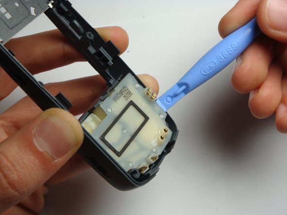

    • Pry out the power unit once the metallic plate has been removed.
  11. Nokia 2128i Power Unit Replacement: crwdns2935265:011crwdnd2935265:01crwdnd2935265:01crwdne2935265:0
    • Be sure to place the power unit back into the phone's case with the gold hardware pointing upward.
