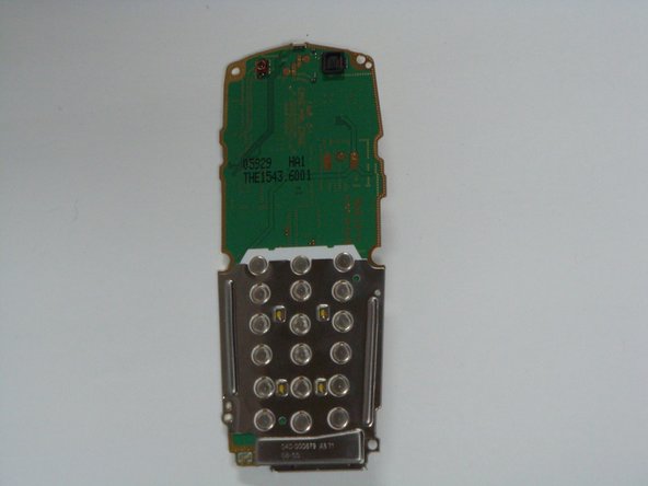

    1. Nokia 2128i Logic Board Replacement, Motherboard Assembly: crwdns2935265:05crwdnd2935265:01crwdnd2935265:03crwdne2935265:0 Nokia 2128i Logic Board Replacement, Motherboard Assembly: crwdns2935265:05crwdnd2935265:02crwdnd2935265:03crwdne2935265:0 Nokia 2128i Logic Board Replacement, Motherboard Assembly: crwdns2935265:05crwdnd2935265:03crwdnd2935265:03crwdne2935265:0
      • Locate and remove the six screws on the front of the phone using a T6 Torx.
      • All 6 screws are 6.9mm long.
    2. Nokia 2128i Logic Board Replacement: crwdns2935265:06crwdnd2935265:01crwdnd2935265:03crwdne2935265:0 Nokia 2128i Logic Board Replacement: crwdns2935265:06crwdnd2935265:02crwdnd2935265:03crwdne2935265:0 Nokia 2128i Logic Board Replacement: crwdns2935265:06crwdnd2935265:03crwdnd2935265:03crwdne2935265:0
      • After removing screws, lift the motherboard assembly straight off the cell phone body.

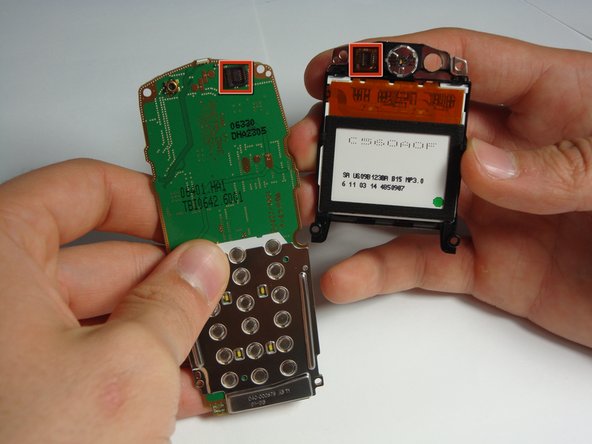

    1. Nokia 2128i Logic Board Replacement, Logic Board: crwdns2935265:07crwdnd2935265:01crwdnd2935265:03crwdne2935265:0 Nokia 2128i Logic Board Replacement, Logic Board: crwdns2935265:07crwdnd2935265:02crwdnd2935265:03crwdne2935265:0 Nokia 2128i Logic Board Replacement, Logic Board: crwdns2935265:07crwdnd2935265:03crwdnd2935265:03crwdne2935265:0
      • Locate the two plastic LCD unit hooks.
      • Pry hooks outward.
    2. Nokia 2128i Logic Board Replacement: crwdns2935265:08crwdnd2935265:01crwdnd2935265:03crwdne2935265:0 Nokia 2128i Logic Board Replacement: crwdns2935265:08crwdnd2935265:02crwdnd2935265:03crwdne2935265:0 Nokia 2128i Logic Board Replacement: crwdns2935265:08crwdnd2935265:03crwdnd2935265:03crwdne2935265:0
      • Gently pull LCD unit away from the logic board.
      • Be careful not to damage the connection on the top, right hand side of the logic board.
