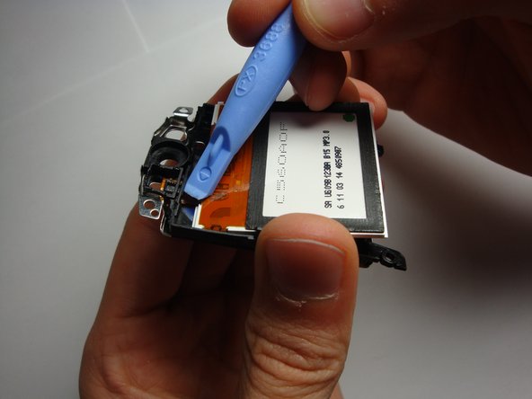

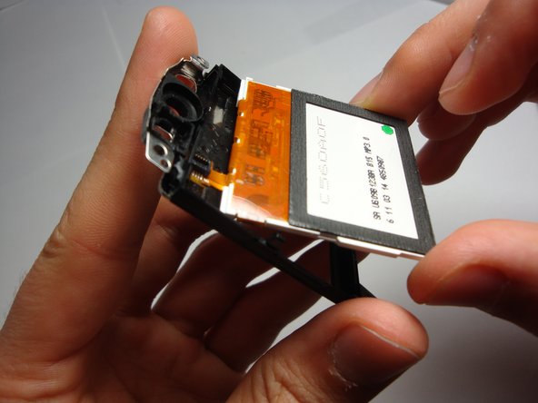

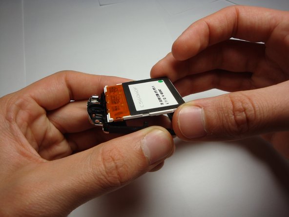

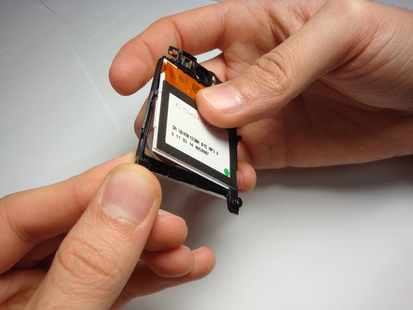

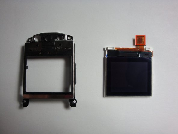

    1. Nokia 2128i LCD Screen Replacement, LCD Screen: crwdns2935265:08crwdnd2935265:01crwdnd2935265:03crwdne2935265:0 Nokia 2128i LCD Screen Replacement, LCD Screen: crwdns2935265:08crwdnd2935265:02crwdnd2935265:03crwdne2935265:0 Nokia 2128i LCD Screen Replacement, LCD Screen: crwdns2935265:08crwdnd2935265:03crwdnd2935265:03crwdne2935265:0
      • Pull one of the bottom corners of the rubber casing outward and detach LCD screen.
    2. Nokia 2128i LCD Screen Replacement: crwdns2935265:09crwdnd2935265:01crwdnd2935265:03crwdne2935265:0 Nokia 2128i LCD Screen Replacement: crwdns2935265:09crwdnd2935265:02crwdnd2935265:03crwdne2935265:0 Nokia 2128i LCD Screen Replacement: crwdns2935265:09crwdnd2935265:03crwdnd2935265:03crwdne2935265:0
      • Once the LCD screen is detached from a majority of the rubber casing, pry out the highlighted portion.
    3. Nokia 2128i LCD Screen Replacement: crwdns2935265:010crwdnd2935265:01crwdnd2935265:02crwdne2935265:0 Nokia 2128i LCD Screen Replacement: crwdns2935265:010crwdnd2935265:02crwdnd2935265:02crwdne2935265:0
      • The highlighted portion is fragile. Pry gently when removing from rubber casing.
