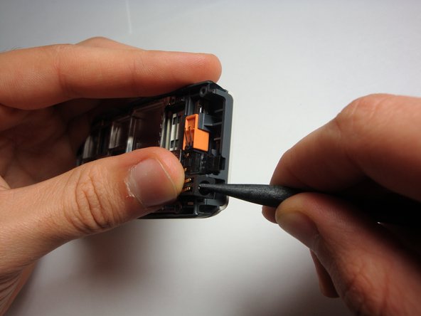

    1. Nokia 2128i Charging Port Replacement, Charging Port: crwdns2935265:07crwdnd2935265:01crwdnd2935265:02crwdne2935265:0 Nokia 2128i Charging Port Replacement, Charging Port: crwdns2935265:07crwdnd2935265:02crwdnd2935265:02crwdne2935265:0
      • With the logic board and LCD unit removed, gently pry out the charging port.
