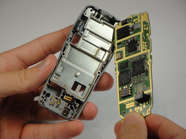

    • Flip the phone over so that the screen faces down.
    • Press the gray button on the battery cover and slide it down off the back of the phone.
  2. Nokia 1100b RH-36 Motherboard and Keyboard Replacement, Battery: crwdns2935265:02crwdnd2935265:01crwdnd2935265:01crwdne2935265:0
    • Wedge the flat end of the spudger into the small indent next to the Nokia logo on the battery.
    • Gently pry the battery out of the phone.
  3. Nokia 1100b RH-36 Motherboard and Keyboard Replacement, Inner Casing: crwdns2935265:03crwdnd2935265:01crwdnd2935265:02crwdne2935265:0 Nokia 1100b RH-36 Motherboard and Keyboard Replacement, Inner Casing: crwdns2935265:03crwdnd2935265:02crwdnd2935265:02crwdne2935265:0
    • Remove the six 6mm T6 Torx screws around the edge of the front of the phone.
    • Remove the metal frame holding the screen and speaker.
  4. Nokia 1100b RH-36 Motherboard and Keyboard Replacement, Motherboard and Keyboard: crwdns2935265:04crwdnd2935265:01crwdnd2935265:02crwdne2935265:0 Nokia 1100b RH-36 Motherboard and Keyboard Replacement, Motherboard and Keyboard: crwdns2935265:04crwdnd2935265:02crwdnd2935265:02crwdne2935265:0
    • Gently lift motherboard unit out of the case.
    • The motherboard and keyboard are one unit and are replaced together.
