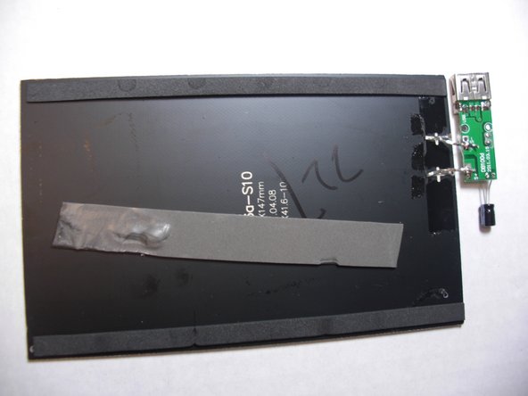

    4. Nokero SunRay Pro Power Panel USB Assembly Replacement: crwdns2935265:04crwdnd2935265:01crwdnd2935265:02crwdne2935265:0 Nokero SunRay Pro Power Panel USB Assembly Replacement: crwdns2935265:04crwdnd2935265:02crwdnd2935265:02crwdne2935265:0
      • Use the Phillips precision screwdriver to unscrew the two 5.0 mm Phillips screws from the circuit board.
      • Remove the solar panel and circuit board from the front case.

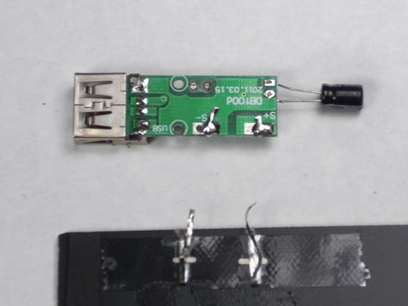

    1. Nokero SunRay Pro Power Panel USB Assembly Replacement, USB Assembly/ Solar Panel: crwdns2935265:05crwdnd2935265:01crwdnd2935265:02crwdne2935265:0 Nokero SunRay Pro Power Panel USB Assembly Replacement, USB Assembly/ Solar Panel: crwdns2935265:05crwdnd2935265:02crwdnd2935265:02crwdne2935265:0
      • Solder the two contact points identified by the "S+" and "S-" to disconnect the USB assembly.
