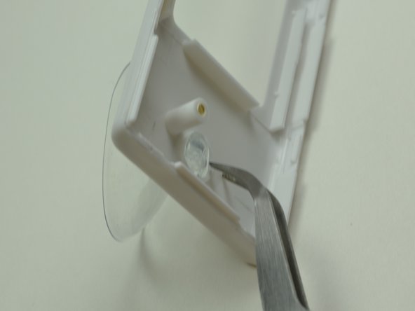

  4. Nokero N400 Suction Cup Replacement, Begin Removal: crwdns2935265:04crwdnd2935265:01crwdnd2935265:02crwdne2935265:0 Nokero N400 Suction Cup Replacement, Begin Removal: crwdns2935265:04crwdnd2935265:02crwdnd2935265:02crwdne2935265:0
    • Using tweezers, push the edges of the back end of the suction cup inward.

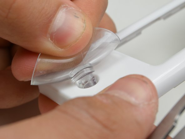

  5. Nokero N400 Suction Cup Replacement, Remove Suction Cup: crwdns2935265:05crwdnd2935265:01crwdnd2935265:02crwdne2935265:0 Nokero N400 Suction Cup Replacement, Remove Suction Cup: crwdns2935265:05crwdnd2935265:02crwdnd2935265:02crwdne2935265:0
    • Flip the cover over and remove the suction cup by pulling at an angle.
    • Be careful not to tear the plastic housing.
    • During reassembly, make sure to press down uniformly on the suction cup for an even fit.
